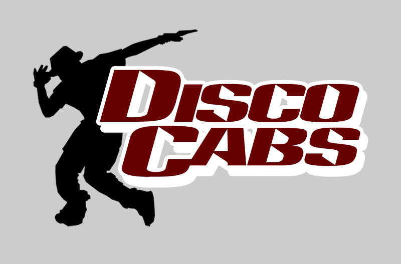

Im a Stock Car signwriter well versed in using paint/airbrush, but Ive just decided to branch out to vinyl. First job signing a taxi in a single colour of vinyl went V well, but Ive got myself another job signing up another taxi - this time it'll involve layering up using 3 colours.
I'll post a pic of the logo I'll be using - My main concern is layering the bordered lettering over the black figure and could do with some advice!
To my limited knowlege I have 2 options:
1. Cut and apply the figure in its entirety (ie including the bit of him that is obscured in the image by the overlapping text)) but this will surely leave an unsightly ridge through the letter D on the finished article).
2. Cut out only what you can see of the black figure, and try and 'match up' the text and figure perfectly - surely quite tricky do because of the backing paper, unless I cut round the shape of the figure after weeding is completed?
I'm sure Im missing a trick, and would love some advice!!
Thanks in advance chaps. Heres the image...

I assume you are putting this on a background other then white, therefore you need to include the shadow.
I would weld both the man and the shadow together. Put that down. Then cut the black man and apply that on top of the white. Do the same for the burgandy letters. Done

Thanks indeed for the reply. Yes the taxi is a deep silver colour. I think I'm with you - merge the man and shadow, so the white layer is an outline of the whole graphic, then layer the elements on top of that? I guess I's then need to be very exact when laying down the black man, or I'll get traces of white vinyl around the edge?

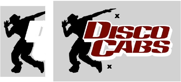

Like the previous poster said just remove that section of the guy
if your worried about lining it up cut registration marks with each color and remove them afterwords (if you dont have registration marks use something like the letter x as shown

i do these type of vinyl all on a single layer. the black is cut thru where the white goes. the white is cut thru where the maroon sets. this way it is only 1 single layer of vinyl.
most sign programs can do this, also corel draw will do this pefectly. set the words ontop ot the white, in hairline, select the whole thing, go to ARRANGE, THEN SHAPING, and in the flyout you will see intersect and cut thur.........been a while since ive done one but this will give you cut out in the white the burganfy letters can sit in.

if i had to do that i would either
a/ put a white outline on the black figure, weld to white o/l round text. This makes alignment very easy or
b/ leave a 1 mil gap between black man & text - looks fine
visual800
if it were me I would cut the white shadow first then lay down the lettering and THEN lay down the dude making the places where the lettering hit on him be a void.
second I would suggest as other said digital printing it would all be done in one shot and you could make some cool shading in your logo

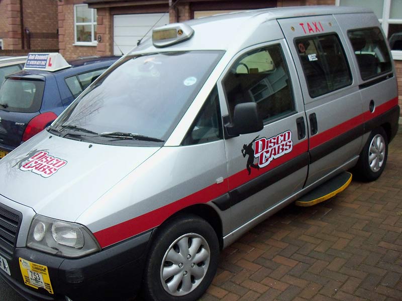

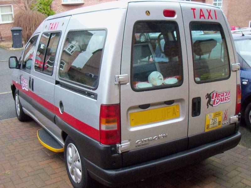

Just like to say thanks for all the advice chaps - and indeed special thanks must go to Tyrantdesigner, who's thinly disguised insult/parody of my design with the added black border actually provided a good workaround. Thats why I registered on here - to pick the brains of those more experienced. The taxi is now done and Disco Jon is tres happy.
