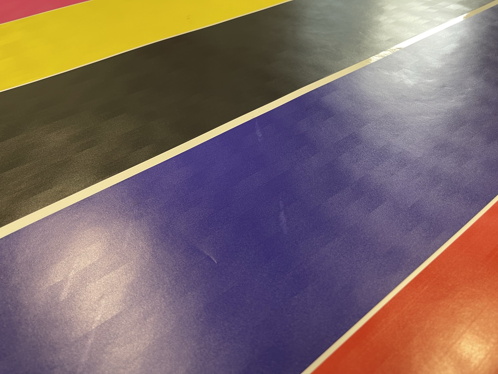

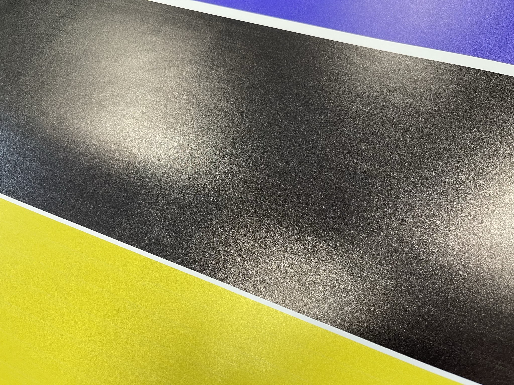

Today the technician stopped by to fix something and showed him the print results from RMO. The higher the print quality the worse the output. The banding in the black printout is "quality" mode and the blue is "HD". He said he doesnt think he could fix this as it shouldn't be a hardware issue, he is escalating it to his colleagues.
What do you think? As mentioned earlier, flatbed is fine, this is happening while printing to roll.

AlsEU
According to the Oce's Technical Service Manual HD prints have no ship print or quality viewing specification. It's best suited for images with a lot of text or fine lines. The optimal resolution requires uni-directional printing. I suppose that the HD print was made bi-directionally.
The quality print - how the black head nozzle test looks like? Was this print made with pure K ink or composed with all colours using the ICC profile? If you print solid areas with pure CMYK inks, do all other solids look good or have the same banding issue? Did you check the calibration of the heads?
