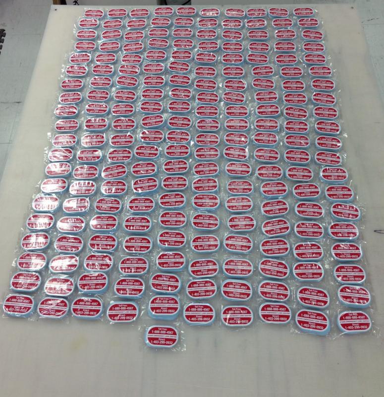

Poly tube does look very nice.
201 packages... very quick to do these... professional looking too! :thumb:

Xcesiv
thanks for the photo tim.
by the looks of poly bags they are air tight? is this right
Is shrink wrap air tight too?
do you think air tight is an advantage

Tim Aucoin
Shrink wrapping is generally not air tight, as part of the process of a shrink wrapper is to poke tiny little holes in the film so that when it heats, the air has somewhere to escape. The poly bags on the other hand are air tight!
how many decals per bag?
They are 50 per bag, back slit for crack'n'peel. 10,000 was the order!
