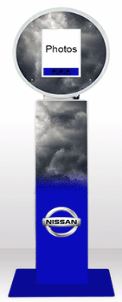

Uncle Bun you are correct, there is no booth it's an IPad on a stand. Here is the best pic I can find. It will be outside for 1 week per the customer. I was thinking the 3m IJ 35 print from SIgns365 would be sufficient with the gloss laminate? He said it's all flat pieces with just the rectangular stand that is actually wrapped.

Looks like an old timey gas pump
I'm still clueless as to what is going on here.
It's a photo booth that is essentially an IPad on a stand. Apparently they wrap these for corporate events. When I spoke to the customer this morning he stated it would be outside for 1 week. Per the artwork it's a flat circle that gets applied to the top where the IPad is and a rectangular wrap around the post. Looks fairly easy. This is a new item my customer just received in stock and the first time he is using it. I found another site that offers the same type of "photo booth" with corporate wraps and they charge an extra $300.

How long do you think it will take to do the job? Apply your hourly rate plus what you need for the vinyl. I agree, if it's flat just used cal. vinyl unlaminated.

The template shows they are just rectangular pieces (2) and one round pieces, so calendared vinyl is fine. My guess is it would take us about 15 minutes of actual time spent cleaning the surface and sticking the vinyl on. It won't really be wrapping; just sticking a piece of vinyl on a flat surface. So we'd probably just charge 1 hour for the labor.

Thanks everyone, I agree, this shouldn't be too difficult of a project and I am going to laminate it also...yes, lots of dirty hands on it so I'm sure they will clean it...at least I hope so! LOL

If it's something they constantly rewrap I'd go with ij40 over ij35 as it's a removable while ij35 isn't. Yes.. If it's only on a week ij35 should still remove semi easy. But if it's outside baking in the sun for 7 days, who knows how much glue will be left behind.
And who knows... If he likes your work you may be rewrapping it for the next event, last thing you want is to spend twice the time removing it and all the glue so you can replace the wrap.

laminate, yes. if anything, it makes it easier to apply/remove.
ij40 vs 35, i wouldn't sweat it... use what you've got. ij35 removes just fine with a bit of love.
as far as what to charge? given the deadline, I doubt they're gonna sweat you over nickles and dimes.... quote them at a full day, at your rate, as a do not exceed and just bill them the time you actually spent on it.

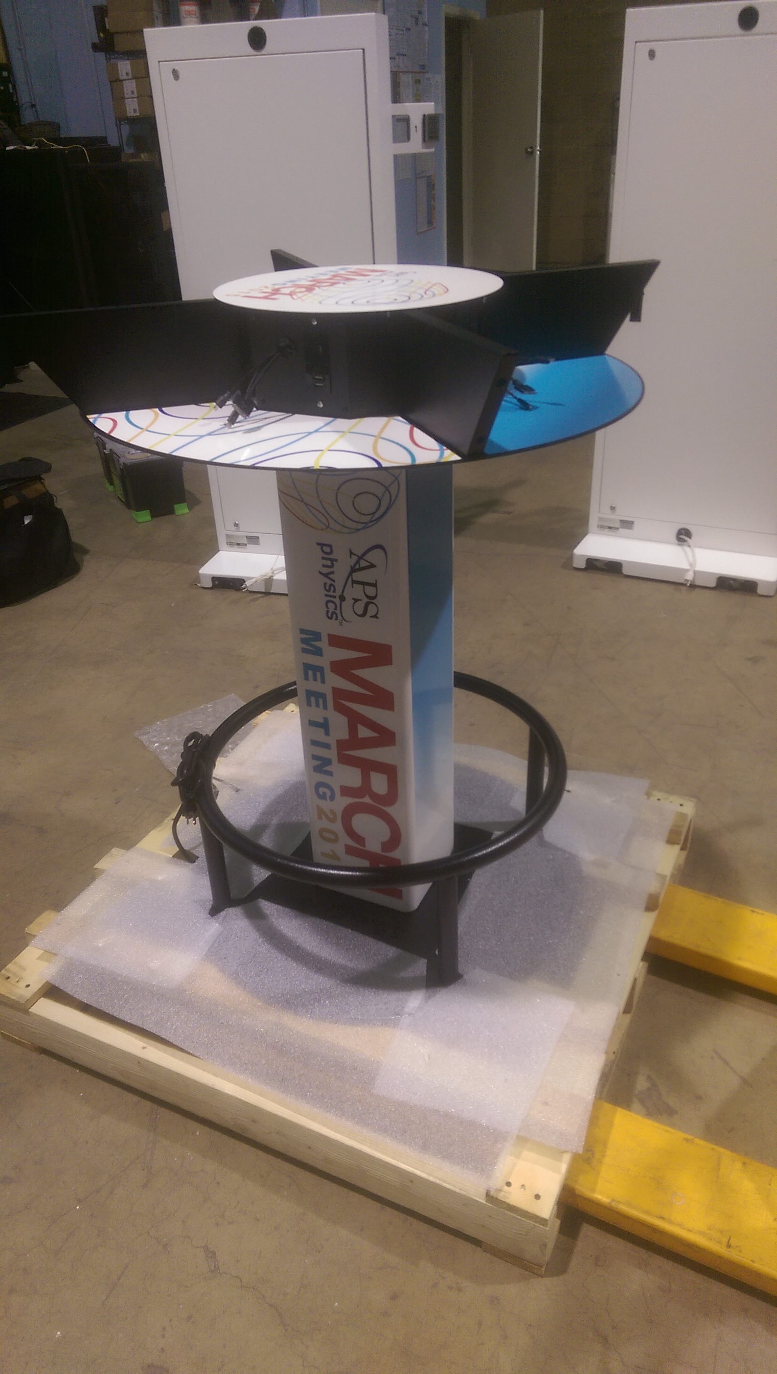

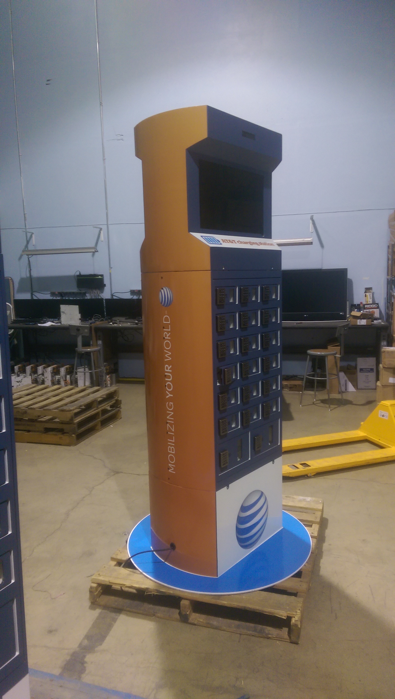

would need an actual picture (360 view) to price but i used to wrap phone chargers similar to that and i charged 150 usually took me about 1 to 1.5 hrs but they used to have a more intricate charging unit with individual doors/cubbyholes for the phone to go in. (it actually locked up your phone while it charged. those i charged 250 because it took longer. had to cut around the doors and buttons.
