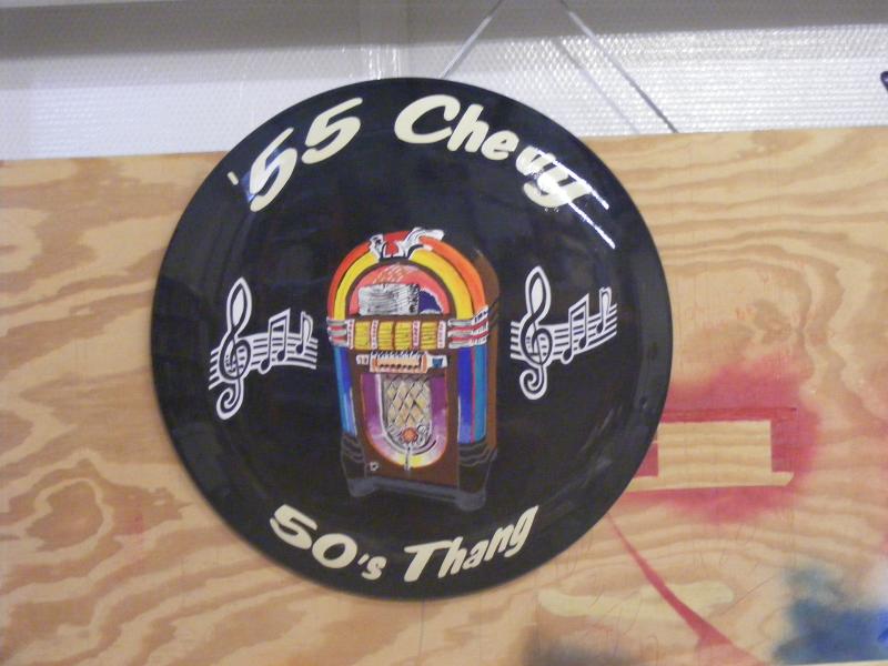

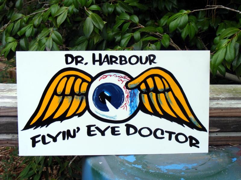

i still paint with all the vinyl .......and use vinyl for masks on a lot of stuff.
