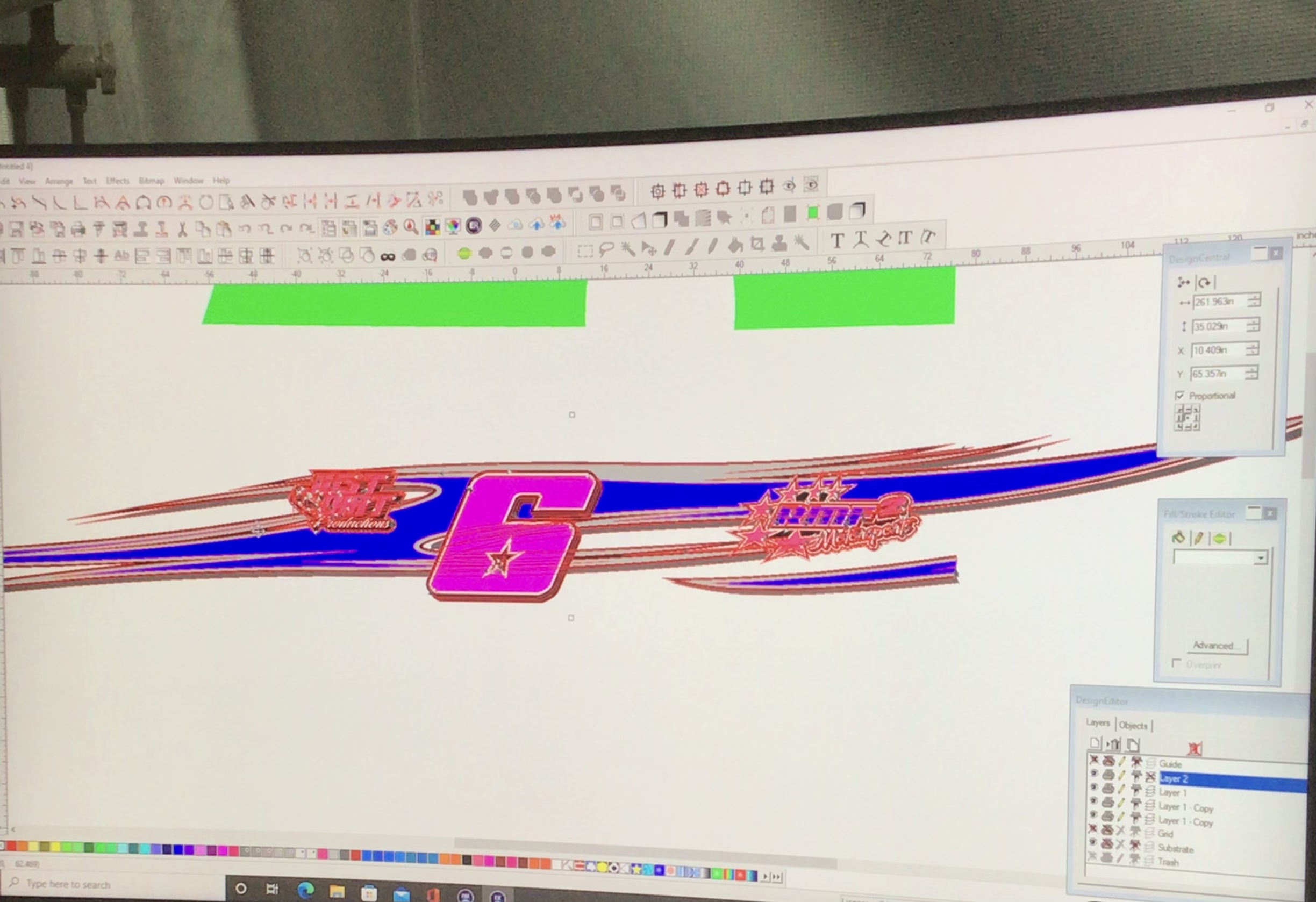

I’m hoping someone can help me. We are completely new to flexi and have been learning as we go. Trying to send the image to the plotter to cut the blue for a holographic overlay and the problem is it wants to cut even where the blue is covered by the solid pink and so on. How can we get it to cut the blue that is actually showing and not all blue lines underneath the other colors? Hopefully I am explaining the issue correctly. I just took a quick picture of the screen hoping it helps!
FrankW
There is a function Color Trap (as far as I remember, ma language is german) in the menu „Arrange“ or „Effects“. Cant have a look currently, here is late evening, Im in bed :)
Connie Fry
Can you remove all your cut lines, then group your images and then add the cutline after grouping. It's worth a try.
