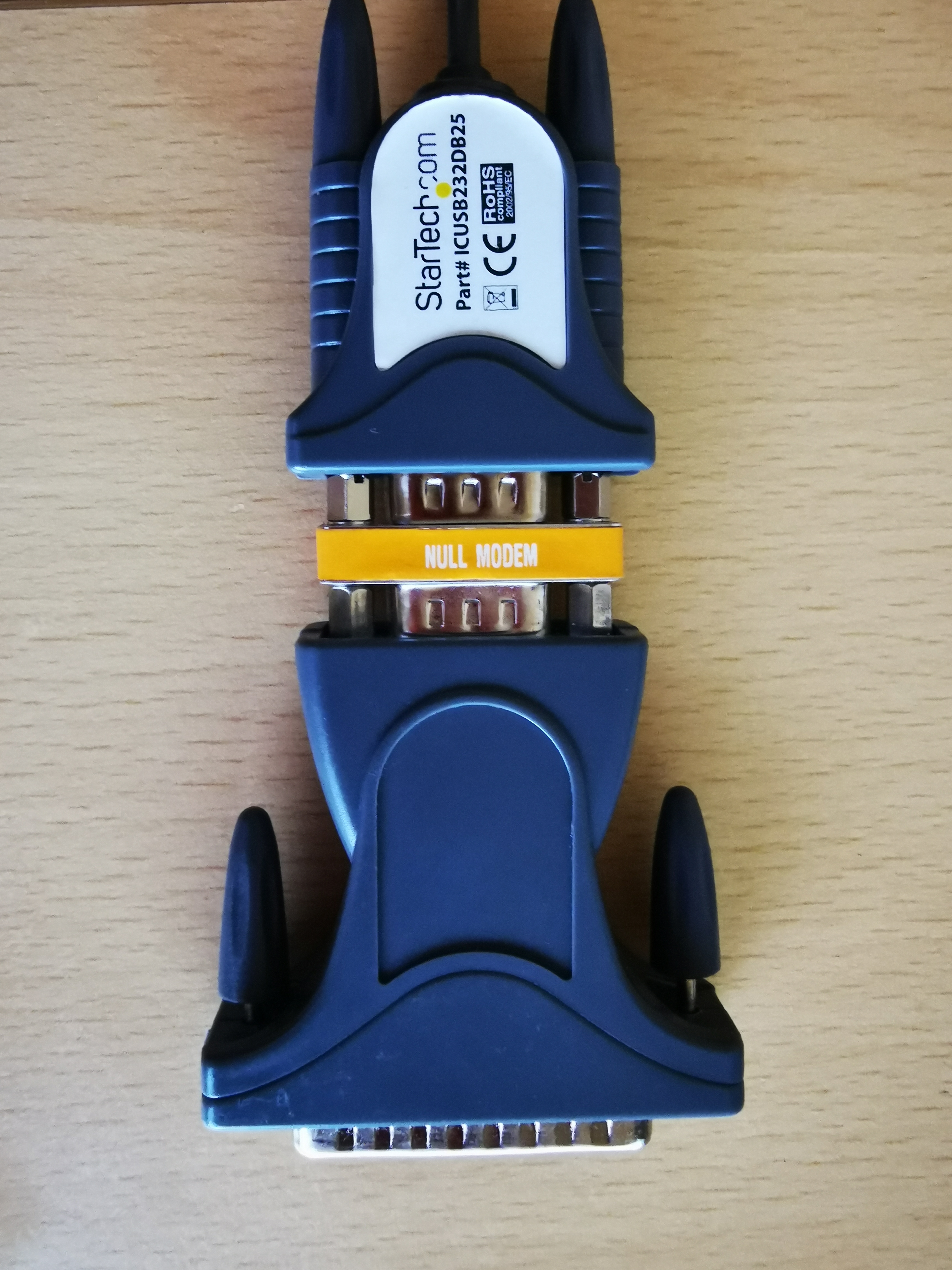

Are you using original Roland cable attached to your CH340 or DB9-25 adapter?
When all DIP are OFF, the handshake is hardwire, but only DTR connected. Roland cable resolves that.
If you use DB9-25 dongle, need to add a M-F null modem adapter in between. and only select DTR in Hardwire handshake option.
Do not install any driver from Roland, they are not compatible with W10, and SignCut can access the port directly.

Thanks for your input! We got it working on Windows 10 with a parallel adapter... And indeed Signcut is the only software that works!
