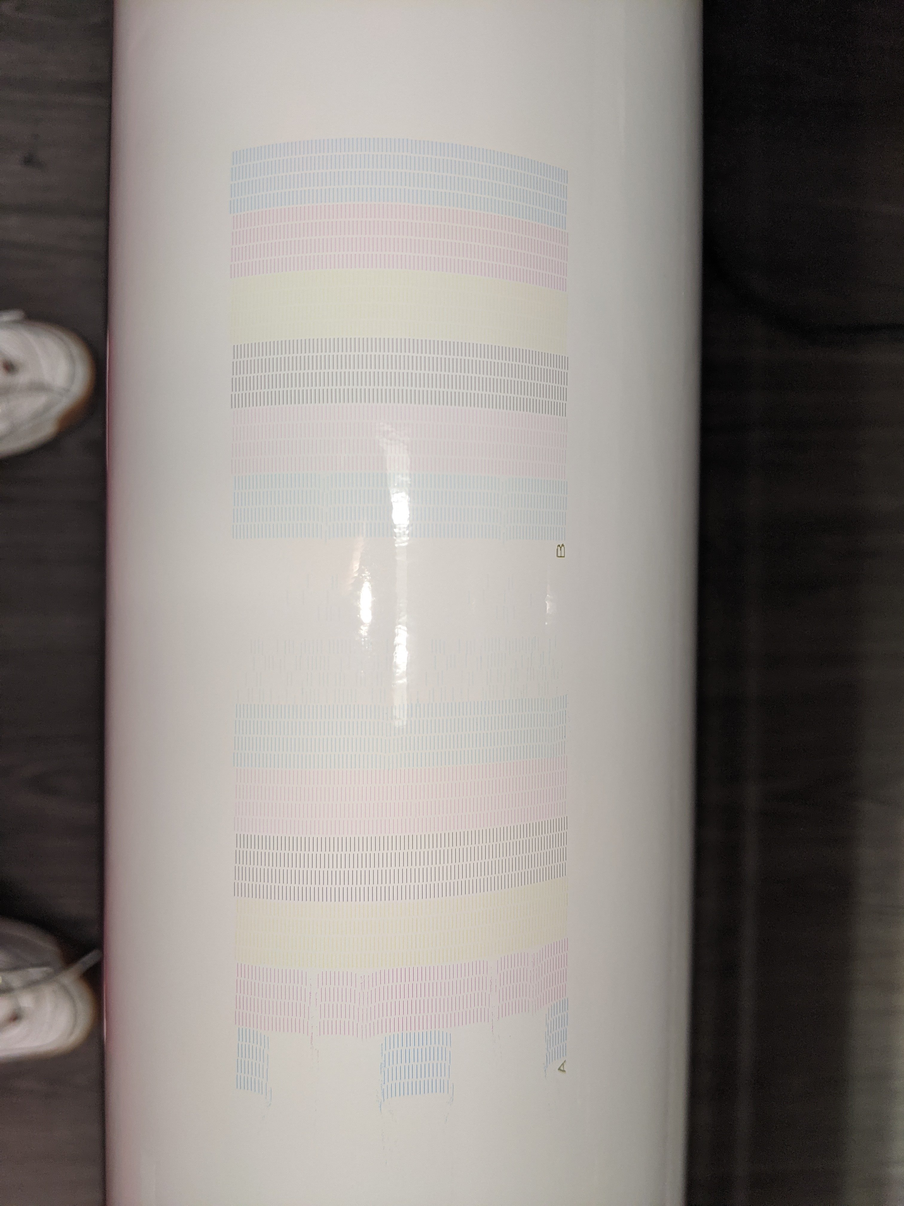

I'm having a pesky test print problem lately though that I need a little more help on. Lurking won't cut it. I've attached an image.
I've done more manual cleanings than I can count, as well as all levels of cleanings. Haven't done a pump-up yet to try and clear it because I only work a few hours a week now and would like to be here while it works its magic. I fear a scratched head because of how it carries over into the magenta, but I don't see any scratches.
This is creating light banding on my prints that seems to be progressively getting worse. Can anybody help point me in the right direction?

Head "A" is showing signs of electronic failure. That's the bending of the nozzles you are seeing.
I would replace both captops, but plan on a head and damper replacement on the "A" printhead.
OzarkDigital
Thoroughly clean your cap tops ... aggressively.
Do a Level 2 A side cleaning several times.
REPLACE THE CYAN CARTRIDGE BUT DON'T THROW AWAY THE OLD ONE JUST YET. We have been fooled 3-4 times before when the ink levels appears to be OK but we're really just sucking fumes through the tubes and starving that ink channel!)
Replace captops (takes about 30 minutes for a first timer --- follow directions very carefully and do NOT lose the retainer springs!)
If that doesn't work, replace the dampers (or have your tech do it).
All this time and minor maintenance money is pittance compared to a $2,800 new head and the $400 labor!

Thank you all for your advice. It has been a while since the last captop exchange. We used to have a tech in town but he quit and now the nearest one is two hours away, so admittedly tech-performed maintenance has been on the backburner, though I try to be on top of most other things.
I've never tried to replace captops as the techs always make it seem like a big undertaking... but if you're being honest about the 30 minute mark, I think I'll be able to swing it (albeit in about two hours if I had to guess :D)
