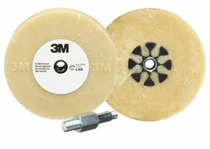

What Ikarasu said. Much easier to go over it if you can but the rapid remover works good. Have you tried the Zapper wheel or 3M remover wheel?
