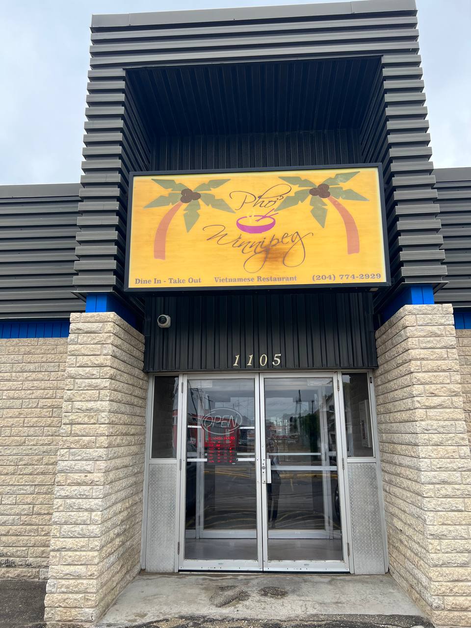

Hi everybody. I recently got approached by a print shop to remove and replace a slide in lexan sign face about 10' off the ground. Size of the face is about 93" x 46” and I plan to go up there with a ladder. This will be my first time doing this.
I figure this will take less than an hour so I will charge $90. Do you guys think I can do this job solo, or is that too big for one person to handle?

But really, Scissor lift would be easier than scaffolding, but not necessarily cheaper, if you have a pair of ladders and a second guy you can grab, I'd set up two A frames. Remove the top trim and right side trim, drop the old sign, lay it over the new to verify size. Also worth noting, either bring the old face down and have the print shop make the new panel to fit, or include a price to trim the new face to match the old. Skill saw with a plywood blade should be all you need.
Oh and yeah, do the service before installing the new face... Nothing beats getting a call a week later and having to jump through hoops to remove a face all over again.

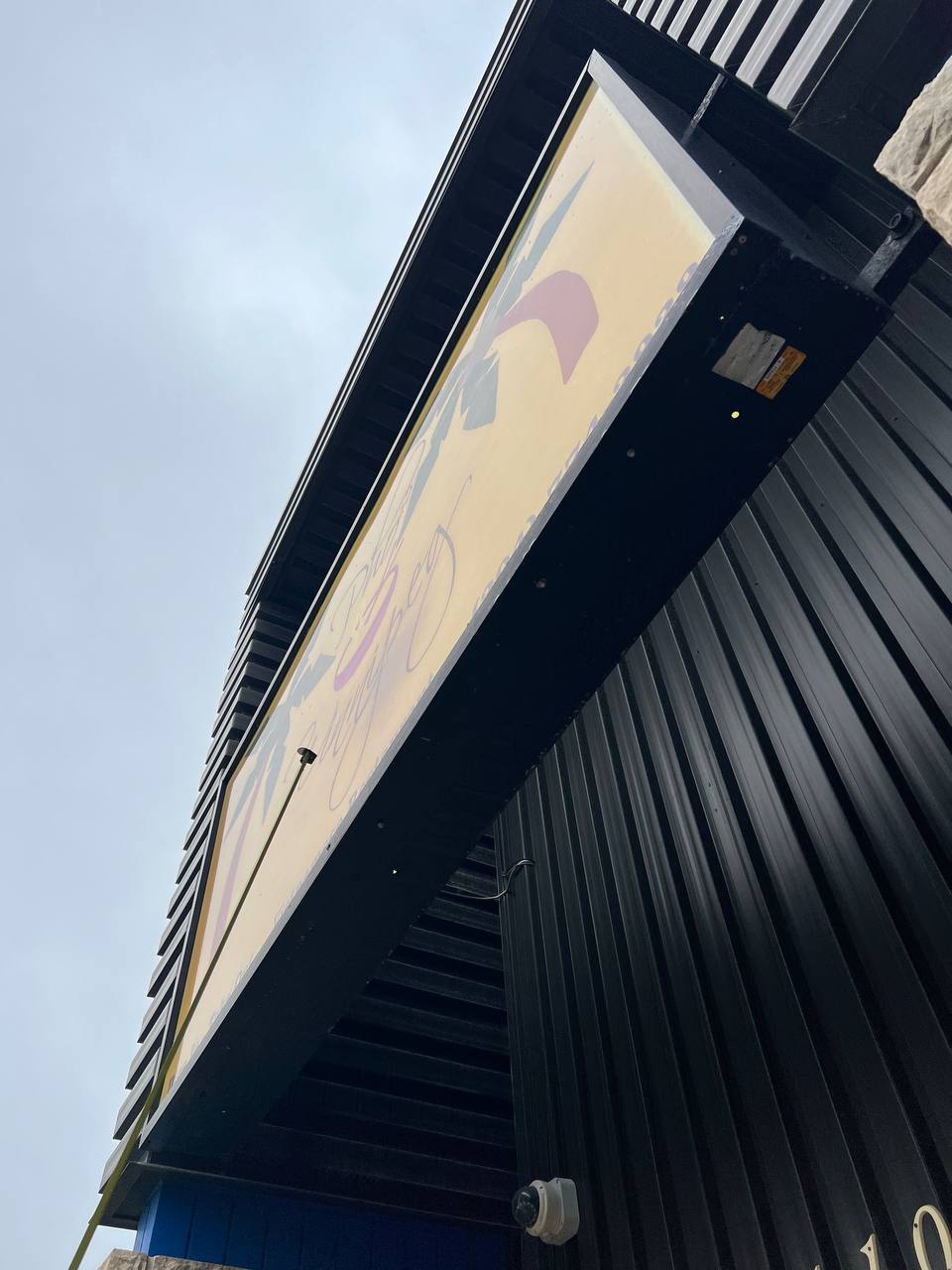

2 guys and 2 ladders might work, but you hafta take that face out the top. It looks like the walls jut out at the sides. Scaffolding...... you'd be better off renting a bucket truck or asking someone who has one to do it for you. !0' to the bottom of the sign, plus another 4' so you hafta pull that sign at least 18' in the air. We'd be around $1,050 + tx. Not charging by the hour, but 1/2 day for bucket truck usage.

Wonder if the top frame and one of the side frames can be removed? Then you can just angle the signs out of and into the channel. If so, I think two people with two stepladders could handle that. If there's budget for a lift, then it would be easier.

Also, now it looks like ya can pull it out either side, so I just don't know on this, but I'd still use the bucket.

Did the company making the face tell you how it goes in? Looks like all the retainers may come off, which would make it pretty easy.
Take off top and two sides and drop face it and put retainers back on.
Install, two guys, two big step ladders, about an hour, maybe more. Plus travel time.
But if they don't know how it opens up add another hour to check it out
