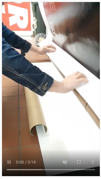

Kemik
I sell stickers and sticker accessories.
I saw this handy trick on Instagram, I haven't tried it yet, but I probably will!
