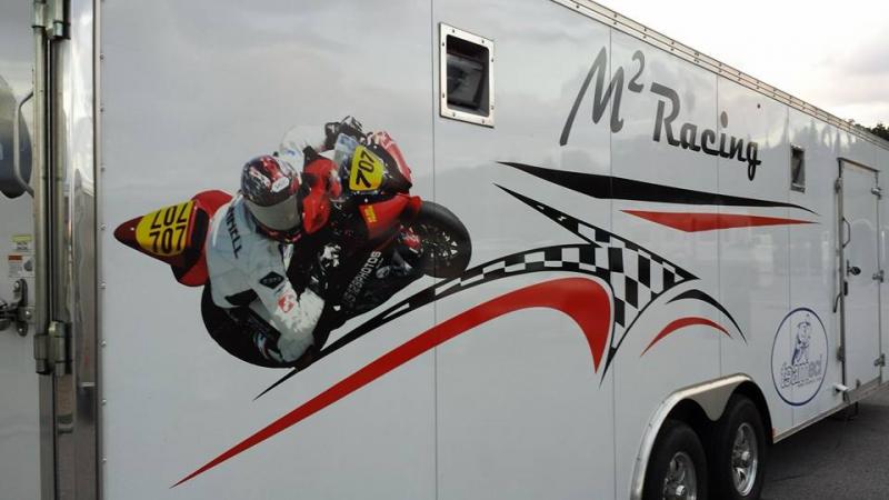

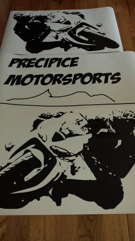

Mine were die cut pieces like this one. 24 x 36 (black rider)
transfer tape very much needed :(
I tried the trailer graphic. It was a catastrophe to transfer tape. Would never do a trailer die cut graphic again :banghead:
(customer applied it)
When die-cutting gotta use the transfer tape.......go paper. S'N'S said, clear sucks. Tape away and roll outwards to avoid the tunnel'n. Also, go "Home of the Milk-Day Queen"
