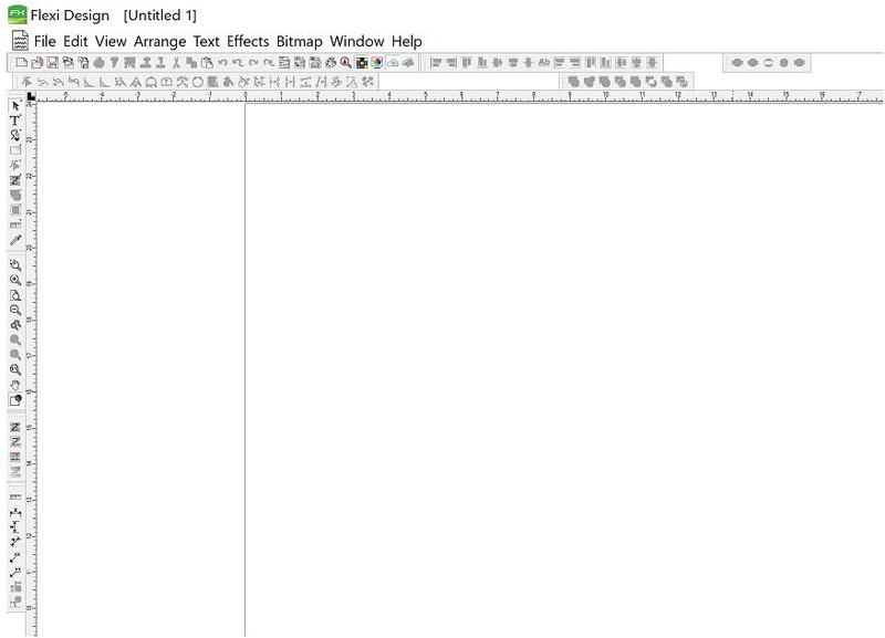

Hey I bought a new laptop & loaded Flexi 12 cloud, but when I open it the icons are super small. Does anyone know how to fix this?

If the screen is 4k there is nothing you can do with Flexi. You can use the zoom feature of windows but it will only work on part of the icons. I recently bought a 32" 4K monitor and had to send it back for the same problem.
eahicks
Change your screen resolution in Windows so everything is a little bigger...e.g., keep it at 1920x1080, even if you have a 4K monitor.

I have been the test mule for flexi and 4k since january. They are working on a fix for it to release to the public. Sai is close on it but it is still unstable. As everyone knows flexi is an adobe based software. They are trying to get it to auto scale like illustrator cc does. Ill keep you posted as it progresses.

I actually just had a guy from Flexi help me a few minutes ago. We did the Team Viewer thing & he loaded something & got me back to where I can actually see everything w/o having a magnifying glass!

I emailed Shawn with a help request. He was out of the office so Radisa helped thru Team Viewer. He got on my computer & downloaded something & got it working.
In Flexi, on the far right side, there is a support button in the cloud page. It takes you to Flexi or Enroute, then you fill in the info & hit submit.
