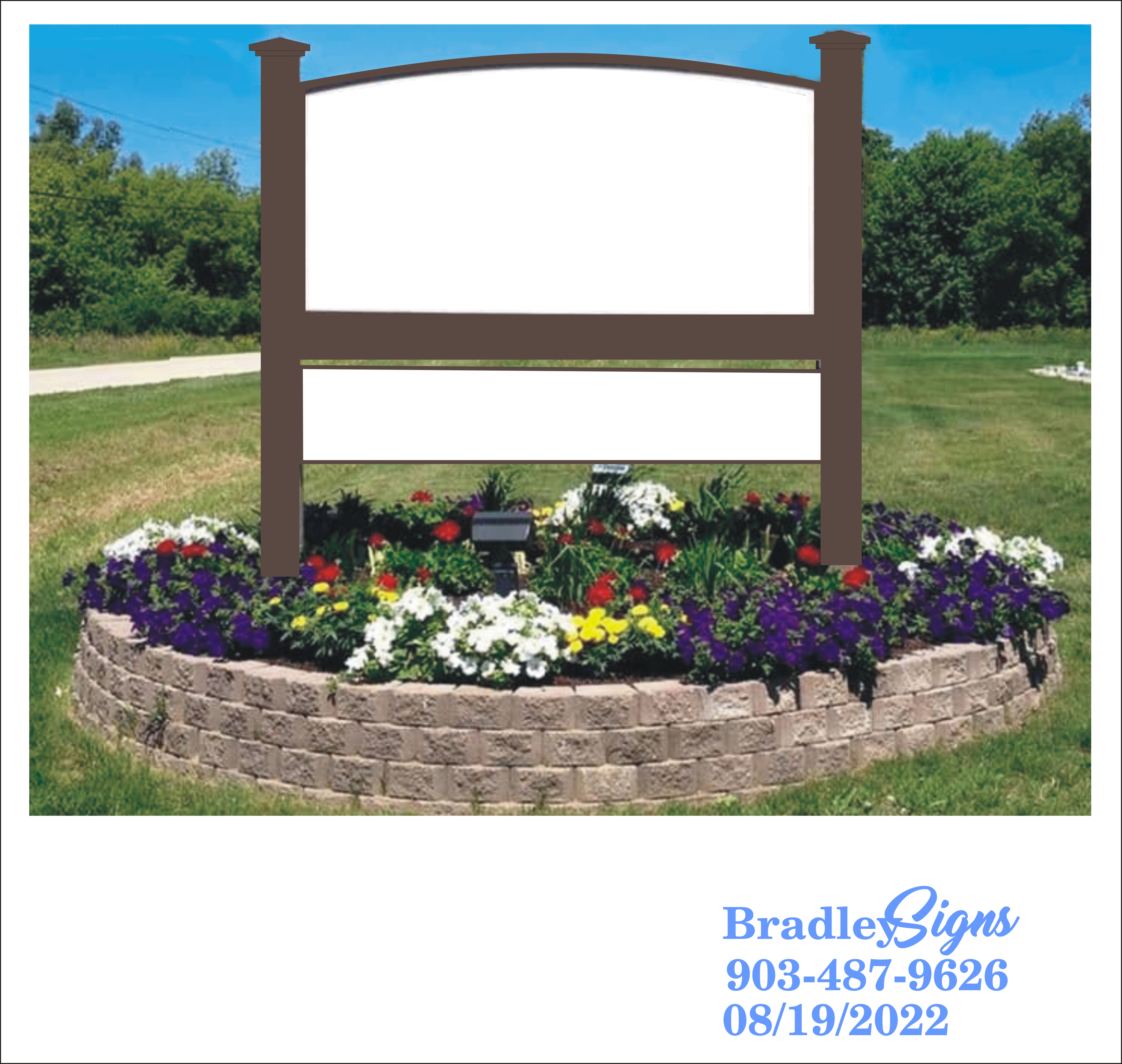

I have a Church that wants a sign built with longevity in mind, so I explained that steel framing may be the answer, and of course regular maintenance is the key.
So, with that being said, if I were to build steel frame work, as in, two steel pole uprights, and a bottom cross bar, a letter "H" type set up, would it better to use sheets of aluminum for faces, mounted on a steel angle frame work, or is there a good solid substrate besides sign board, say, 1/2" thick PVC for example, that I could fasten on each end, to the uprights, with aluminum faces glued to it, or riveted/screwed with stainless fasteners?
I have no idea what materials are available these days for building something that will last a good number of years.
This would be double sided...
This is the shape of things to come....

From your drawing it looked like a single substrate. If I'm doing a double sided sign around here and I'm starting from scratch, I put framework in the middle and use two sheets of aluminum on either side. I feel you on the MDO, I've been getting more fond of it myself, but those sheets get heavier by the day. Hail will damage things, there is no getting away from that. Sounds like you're better off selling him a concrete sign. Those Foamcraft signs that 2B suggested are pretty good too... that polyarmor is tough stuff... trust me, I've have to cut some of that stuff up.

Hahahhaa... Thanx for even looking at the picture. That's what it's there for, and, I'm looking for suggestions on a substrate that might work as a single sheet, nothing more.

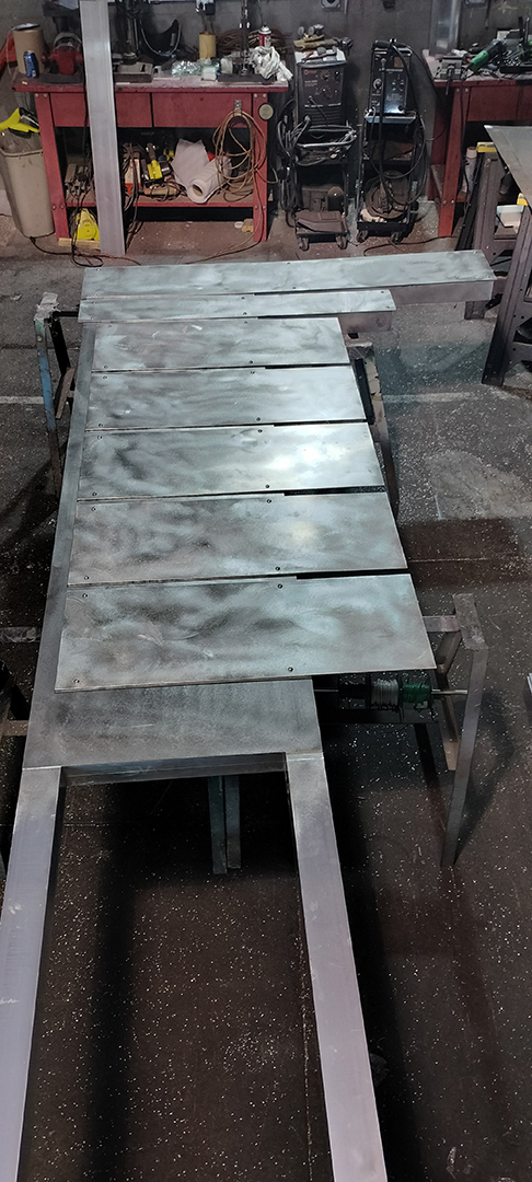

This is all .125 aluminum tube and sheets. After the other side is completed, it will be taken out for powder coating. The legs are 3' x 3" aluminum tubing and run all the way to the top on the inside. The backer board is 1/8" veneered and polished and the panels are also 1/8" stock and polished.
When you want strength and longevity, ya don't use ACM panels for any of this kinda crap.
The really funny part is, I just met with a woman yesterday evening about a sign almost identical to your rough draft in the OP. She wanted to use Cor-X. I almost busted out laughing. She said...... well, it's waterproof. I said, so is your skin, but do you think you could stand outside all day, all night, hot, cold and last for 10 years ??
