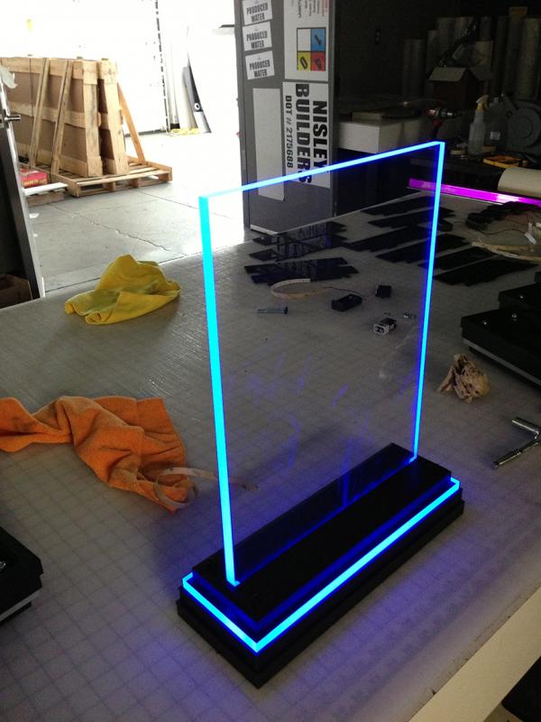

Here is a little something we cooked up today. 19" tall x 15" wide. LED lit face with LED lit ring sandwiched in the base. Base CNC cut from HDPE and 1/2" plexi. Multiple layers, pockets, and holes that line up to bolt the whole base together.
9V battery powered LED's with on off switch. One of the funner projects we have worked on lately...
