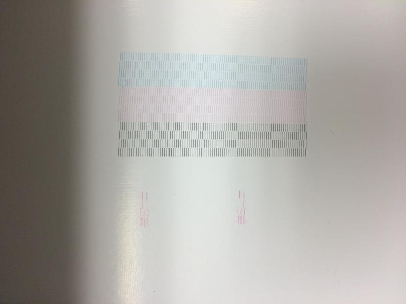

Aloha! My shop has a VS-540 we have been using for quite some time. we have had a few issues this past year so we changed the head and dampers about 3 months ago. everything was working great for a few months, but suddenly last month we have been having some issues with a few ink channels. My cyan channel started getting a lot of deflections which slowly spread to my magenta. I assumed this was from the white ink as we frequently have to replace the cap top because of it. I tried to clean it often, but the cap top did not appear clogged as it normally does.
Last week after the Christmas break i noticed i was losing a large area in the middle of my magenta channel. I tried powerful cleanings and a couple head soaks, but I couldn't get it to come back so i put on a new cap top. Then, on Thursday of last week, I lost my cyan channel completely, even though we had just replaced the ink cartridge. I tried a few more powerful cleanings but could only get a few small sections to come up.
I came in today and now my cyan, most of magenta and yellow are all gone. I tried pulling off the hoses from the cap top and pulling some ink through with a syringe, but i noticed i don't seem to be getting any suction and nothing is coming through the lines. I inspected the cap top and it looks to be in good condition, and it's installed properly. I have the head soaking now. Any ideas what this could be?

So I soaked the head for about 2+ hours and my yellow and cyan came back, but they are pretty sloppy. My current theory is that because the cap top is not sealing on the head it's drying out, and because there isn't enough suction the machine cannot properly pull ink through during the cleaning cycles to clear the clog.

when you are running these powerful cleans, look at the drain bottle. Ink should be dumping into there at an alarming rate. If it's not, then the cap isn't sealing to the head properly. the cap mount itself is adjustable, so sometimes they get knocked or just wiggle out of position over time.
Also, choke clean if you are missing that many nozzles, usually one can get the head just about back to 100% as long as everything is sealing good.
Ed's Sign
Edward S.
So I just did a powerful clean and almost nothing came through into the drain bottle, just a few small drops and bubbles. it looks like the cap is sitting properly, i see the spring compress a bit when I move the head onto the cap, but i clearly am not getting a good seal. How would you go about adjusting the cap mount? is there any instructions out there or would I need to call a tech?

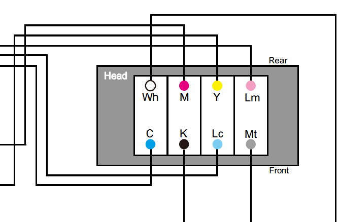

Hey I had to replace my head in the 540i and when re assembling i mixed up the order of the dampers.
Can someone snap a shot of the top of their carriage (with plastic sheeth removed) I need to re set them in the proper order!
LOL - Cyan is Magenta, yellow is black ARGH! please and tanks!
kevin
Ragnabrok
Here ya go.
Be of note this is the color order on the stems, the dampers rotate from the colors on the top of them.
