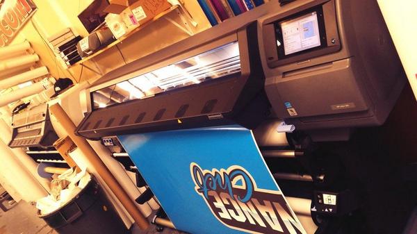

I have the latex 360. It's worth the 5k.
Differences?
the 360 has a take up. It has a cutter to cut media off, and it's faster. the 360 is 64" wide...
It also has a huge touch screen display and displays an image of the printed image.. pretty sweet setup.
the Other machine doesn't have these features.

i see you also use the forward brand banner...that is the only banner i have found that works great with latex...have you found any other that is trouble free like that?
dsgn4
with the key banner..i had issues with pinch roller pattern showing up in some colors..and or darker stripes from what i think is static from the mylar fingers used to keep the material flat at the rollers

That is from plasticizers coming to the surface on PVC banner media. Ultraflex is the worst. I have not had much problem with key banner. Wipe the media down with alcohol and you can print just fine. And no the Latex Optimizer in the L300s make no difference.

So do you think what dsgn is experiencing is from the pinch rollers pushing the plactizer through the banner to the top?
No not pushing it to the top, just pushing it around enough so that you will see the roller marks, but it will show up everywhere not just where the rollers hitting it.
