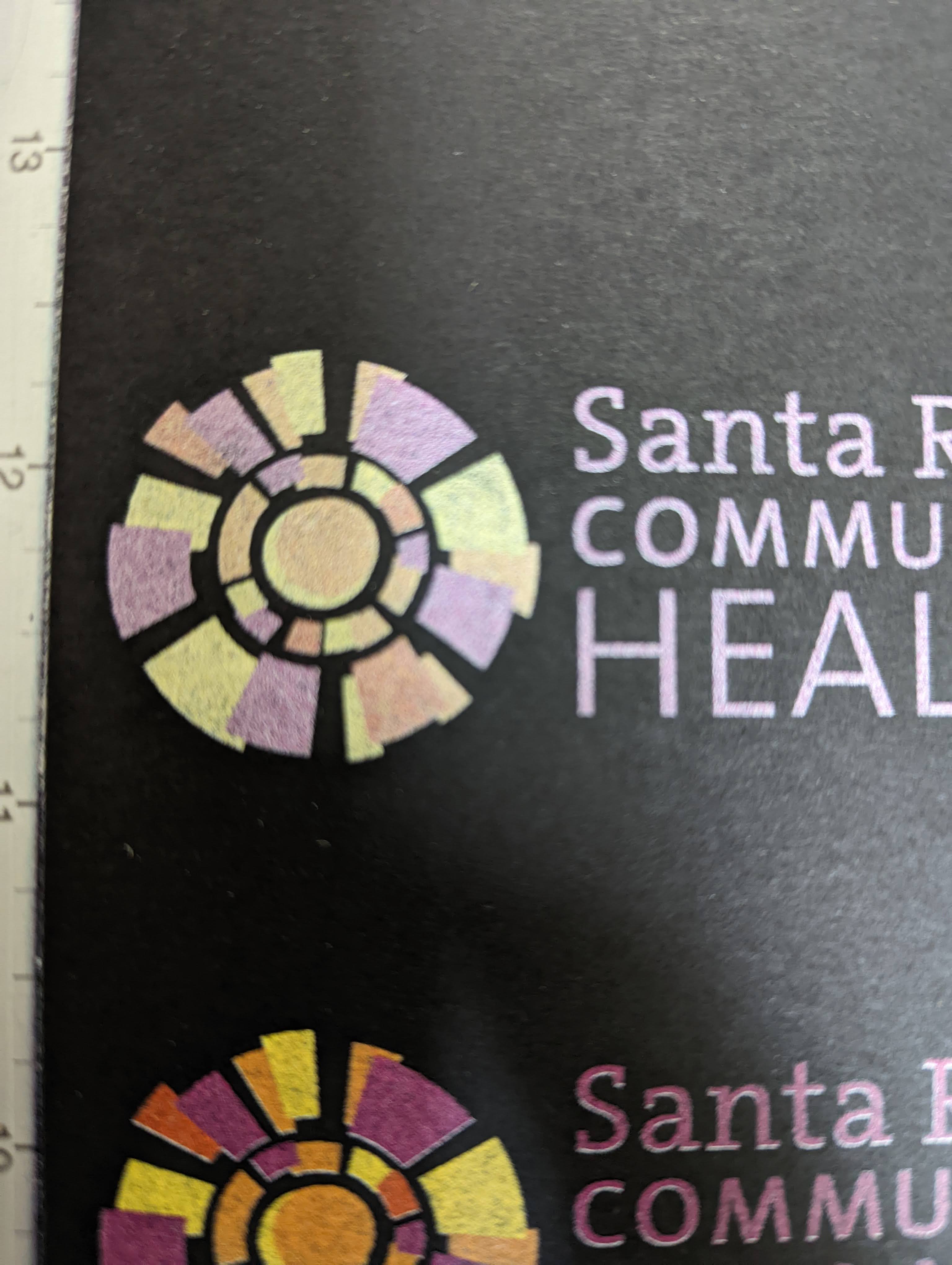

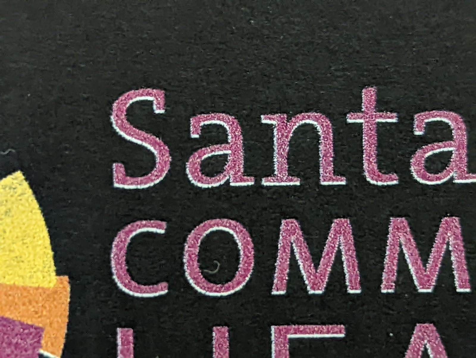

I'm having issues with the alignment of a white undercoat and color top coat.
I regularly print on dark substrates. When I do, I make one file with a solid fill and use that as the spot color, then run a separate file with the color to print on top of the white. On fine detail prints (text especially) there is always some white poking out the bottom, it looks like a white drop shadow. Files are both vector, and lined up according to the RIP and printer.
I've tried different quality settings, as well as bi/uni directional modes without any noticeable difference. It happens across all medias I've tried so I don't think it's the substrate that is causing it.
Does anyone have any advice on how to alleviate this, or is it just something you have to live with?

The problem is a head alignment on the printer.

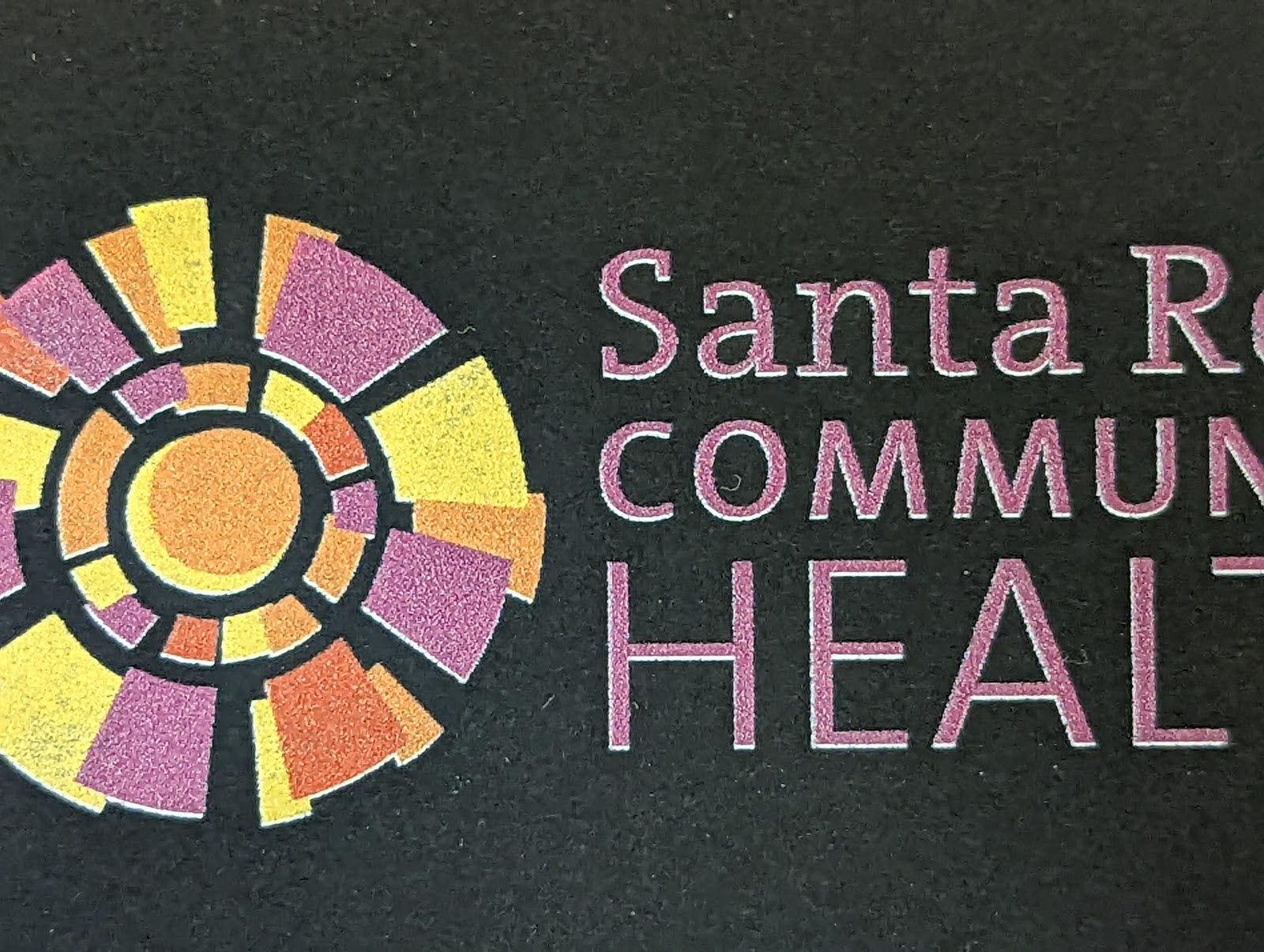

Whenever I've printed both at once the colors never come out right, the colors always seem muted/overpowered by the white. Attached is an example of the same file sent with 'Fill Image Area' on the Spot color rather than printing them separate. Is that the wrong way to go about this? I saw in another post them talking about 'Define Layers' in Printer Settings, but that is always greyed out for me.
Edit: Just found how to use the 'Define Layers', I was in Fine Art not Quality mode. Will give that a shot shortly. Thanks!

The CMYK and White are definitely not aligned. Trapping will certainly help, but I'd still run any alignment calibrations on the printer first.

In addition, even if you have done a perfect alignment the cmyk droplets are different then w, because white pigments are titanoxyd. This makes the ink heavier and the droplets splatter more.

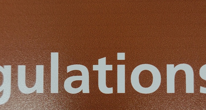

However, I am having trouble with lines under some of the colors.
If I go (bi-directional) If I go (Uni-directional) which is so much slower it doesn't show as much.

-4 is way to much. Points to an alignment issue. I guess the alignment of printheads needs to be done.
