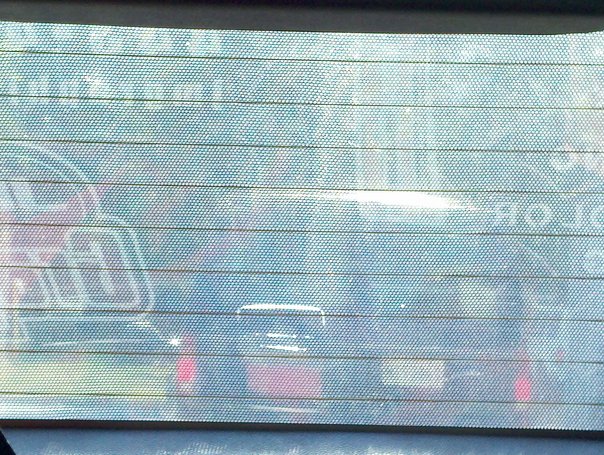

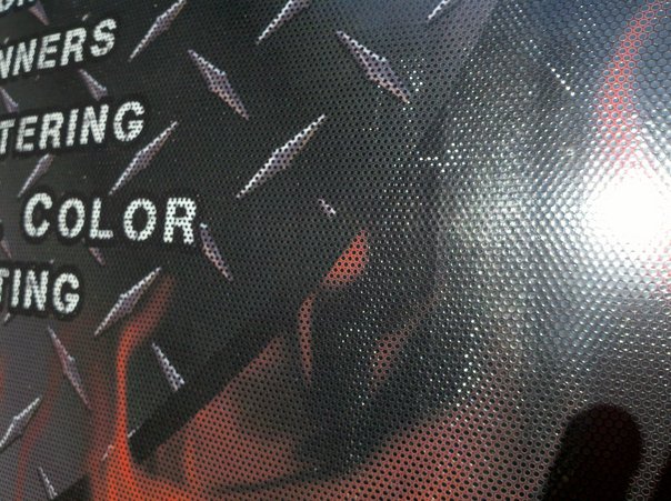

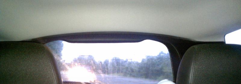

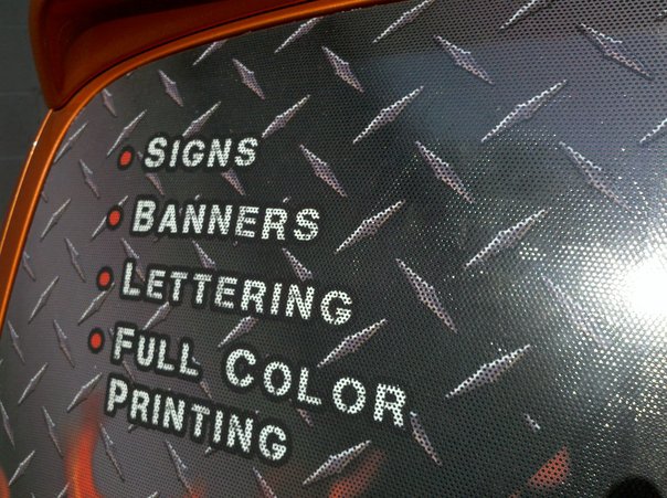

Here is my problems, From the inside it's hazy which is typical with the optically clear lam from what i'm reading and i read a few posts up the marks from the squeegee will disappear in a few days?

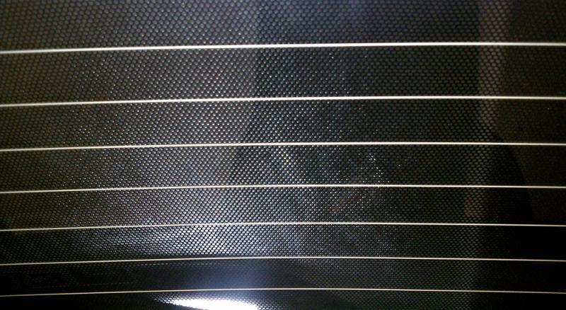

I hope it clears up, it seems the outside bubbles aren't as noticeable already after a few days of 90 degree weather but here are some shots from the inside, it looks terrible but idk if this is normal with perf.
I was hoping to offer this service to my customers but i don't feel it's up to par with acceptable IMO
