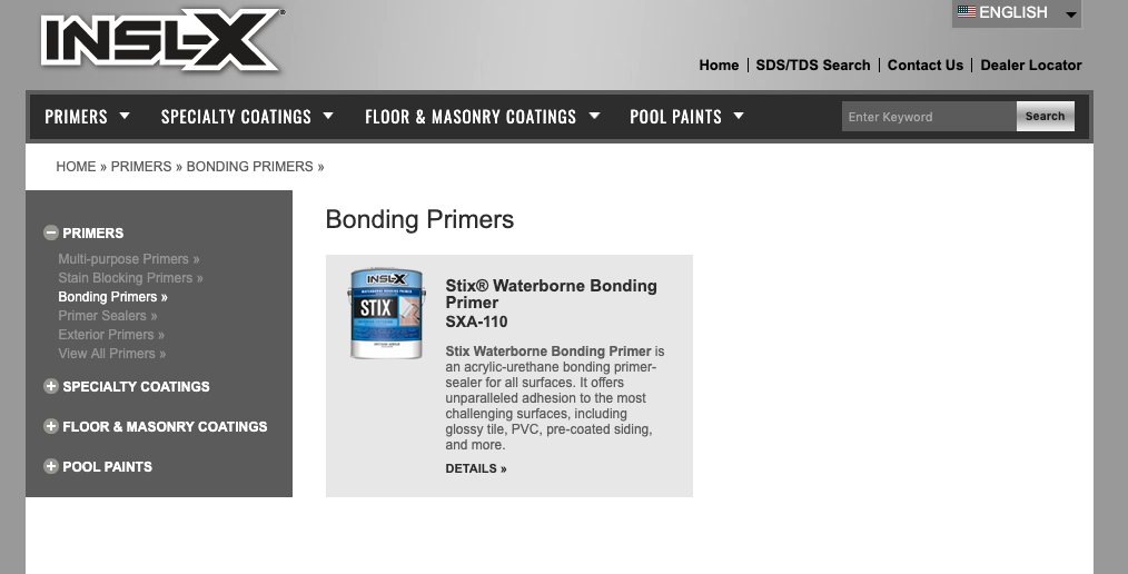

This is the brand primer we use for nearly everything and have had good luck with adhesion on the edges of ACM with it.
If I think I understand what your intent is and it was us, we would cover the ACM with a high performance vinyl as a mask, then rout or engrave leaving the mask in place for painting then peel the mask off.
