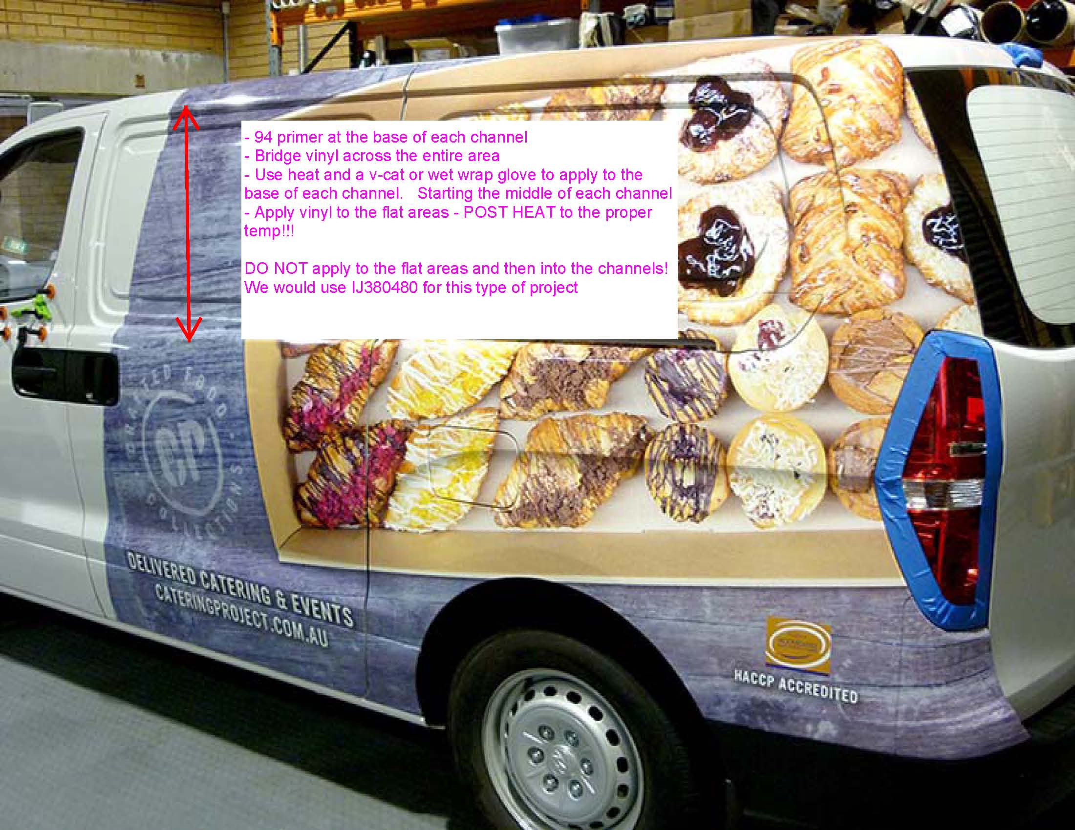

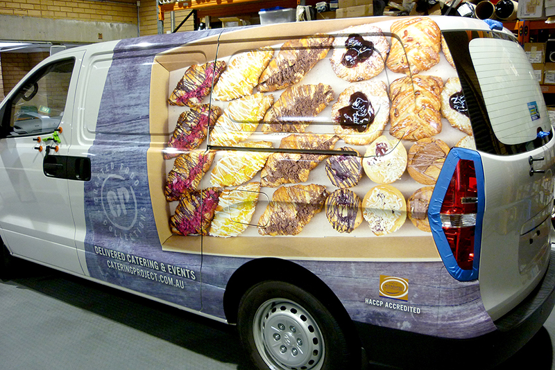

We've done a few.
Which area is it you're having trouble with.. that recess above the wheel?
We just did this one recently.

One piece. Try and heat away from the recess as much as possible.
When done properly it will stay down.
We only expect 3M 480CV3 or Avery 1105 to do the job though.
