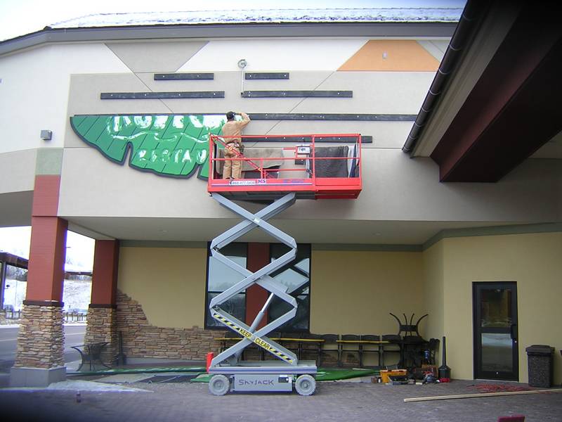

Installing latest project.sign was mounted EIFS wall.I mounted 2X6 treated lumber to the wall with 1/4" toggle bolts that were drilled into 16 ga steel studs.Then mounted the four sections of the leaf to the treated.
