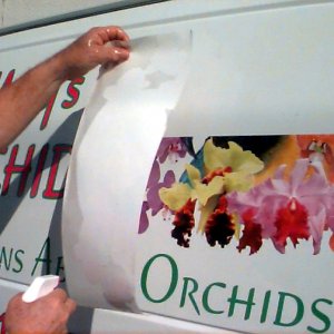

    After a wet application, spray the transfer paper with soappy water to make it easier to remove.

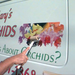

  2. Mary's Orchids 08
    Mary's Orchids 08
    Bottom half of logo applied. After a wet application, rolling over the graphic with a soft roller insures that edges are well adhered.

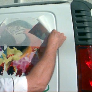

  3. Mary's Orchids 09
    Mary's Orchids 09
    Top half of logo with release liner removed and spraying with soap and water solution.

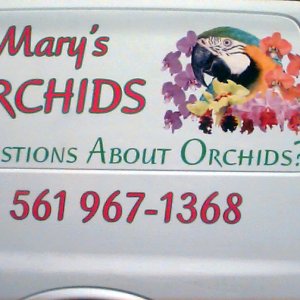

  5. Mary's Orchids 11
    Mary's Orchids 11
    Completed side of van. Logo was created by silhouetting photos of different orchids and the macaw, then arranging them in Photoshop. Entire job was printed on high performance white vinyl with Gerber Edge.

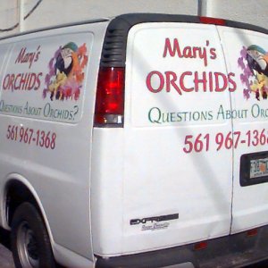

  6. Mary's Orchids 12
    Mary's Orchids 12
    The finished van.
