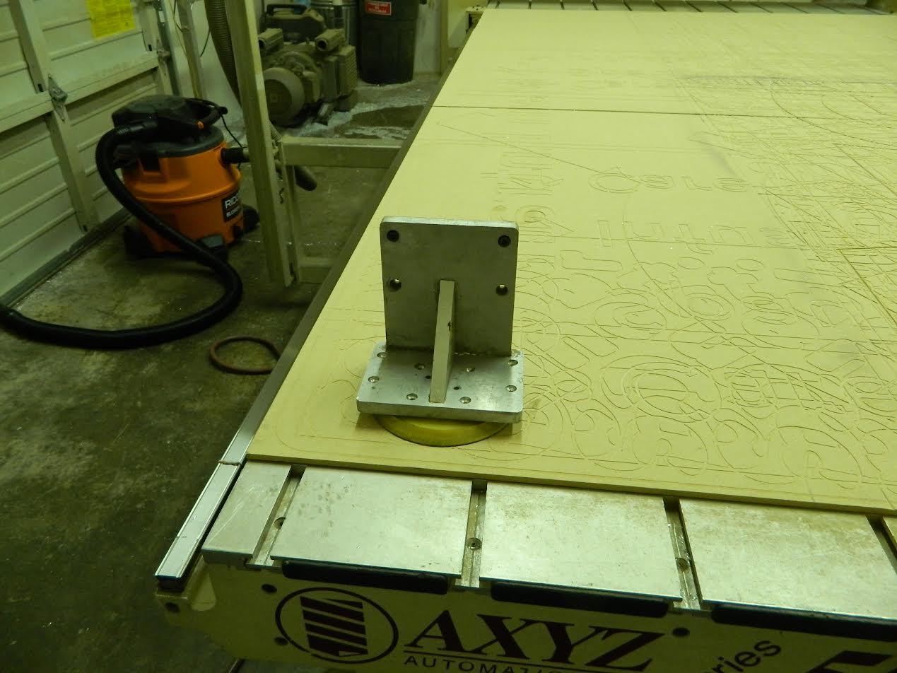

Here's a picture of the other shop's bracket solution, I'd also seen a wire brush version that they through bolted onto this plate, but I can't find that picture now. I found that even with the pad mounted in the spindle, it would find a path of least resistance and stop spinning after a few inches. The wire brush would fix that I imagine.
And when I say wire brush, I guess I mean like steel bristled hand brush, wire brush makes one thing wire wheel:
