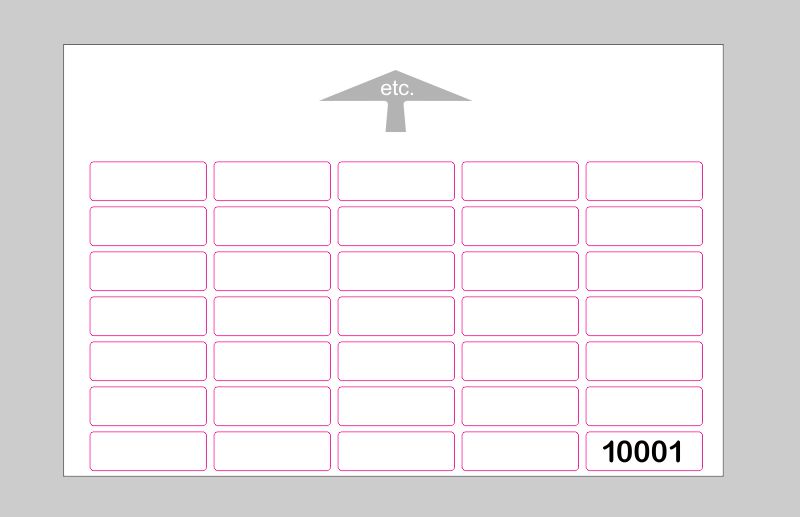

I need to print/lam/cut 500 2" x 6" decals with numbers from 10001 to 10500. I'll be printing these on 36" wide media, and will likely do them in easy to handle batches of 75 or so.
In CorelDraw (X7), how does one do the sequential numbering from 10001 to 10500 without manually keying in each one? I've looked at the "Print Merge" videos, but they don't seem to be what I'm after.
Thanks.
