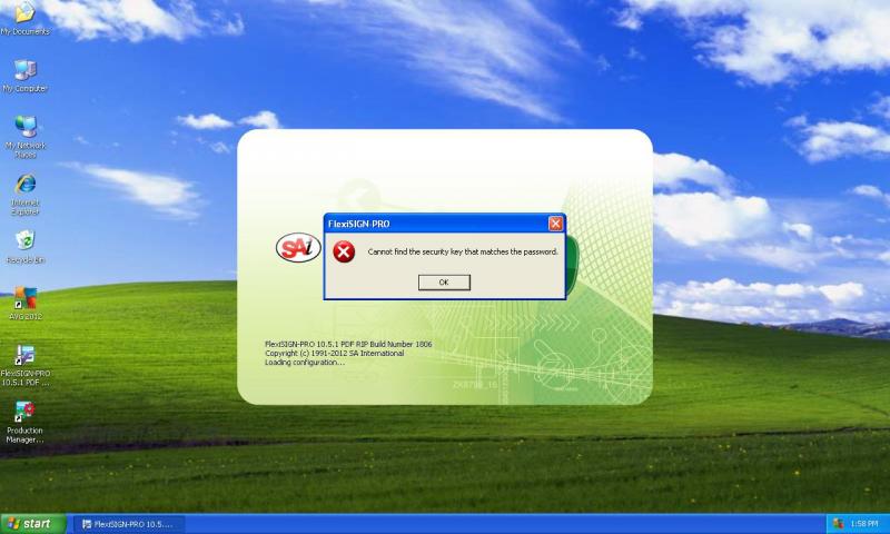

I upgraded from 10.0 to 10.5 yesterday. Not sure what happened what I shut the computer down last night but the computer would not boot up this morning. Got windows XP Pro reinstalled and flexi 10.0 reinstalled, then I reinstalled 10.5. Now when Itry to open either version I get the error message below. I called tech support and left a message but does any one have ideas I can try?

After reinstalling Windows and Flexi, the driver for the USB dongle must not have gotten reinstalled properly. Normally on the installation disk or executable there is an option to also install the USB Sentinel driver, this is most likely what you need to fix the issue.

The file that I downloaded for 10.5 asks for a password that I copy and paste based on my 6 digit user code I used for 10.0. Maybe the one I was using was for 10 and not 10.5, either way I'll try what you suggested.

That's probably what is also causing issues. Yes, you have to get an updated key going from 10.0.X to 10.5.X, so if you had the wrong serial key that would cause it to also display that error message.

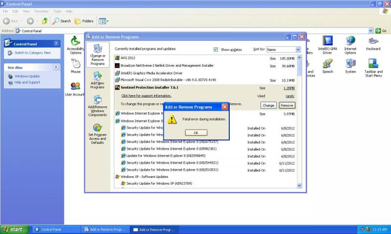

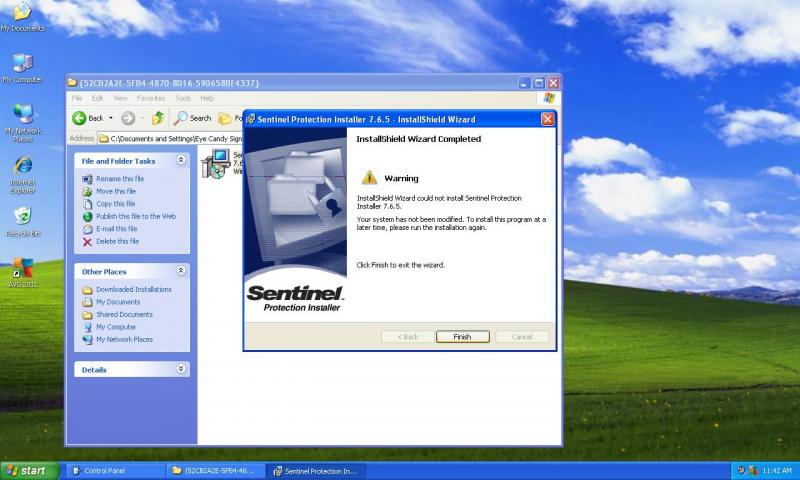

reinstalled 10.5 and it used the hasp driver 7.6.4. Tried to open flexi and I'm getting the same error message as my first post.
choucove, I tried instal the new hasp driver 7.6.5 and it gave me the error as in the pic. I tried to uninstall the 7.6.4 and it will not uninstall either.

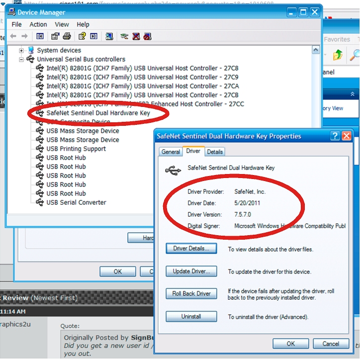

thewvsignguy - When you plug in the USB key does windows recognize it? Should play a sound and give a popup in the corner of screen. Have you checked in Control Panel/Device manager to see if the driver is installed. I'm running XP and flexi 10.5 and I notice the Driver version is older than yours. Maybe that's the problem.
