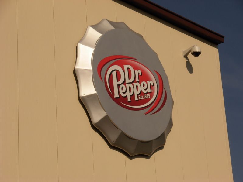

We just delivered 6 of these with various brands. They are internally as well as halo lit. We made the mold in house but had a local fiberglass spray up the parts. We built the cabinets behind the caps.

Routed foam, glued up a male, sanded, primed then sent it to fiberglass guy he sprayed up a female mold. Then the 6 after that were easy.
