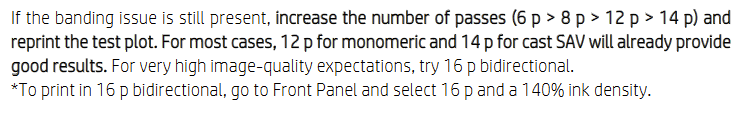

HP have recommended 16 pass at 140 ink density which i think is absolutely ridiculous.

It's the new ink and new printheads that make that banding. On L630 with single row of printheads the issue is almost non-existing. But L700/800 it's bad with some colors and like I said especially Cast vinyl.
95° sounds fine. You sure it was set to 0 on that preset? You can check later from printos how much the overcoat usage was for that job. Should be close to nothing.
The difference is that yes, you can laminate straight after the print comes out (as long as your curing temp is correct and it's dry) BUT you should let the laminate adhesive adhere properly for 24 hours before applying the wrap. It doesn't have to do with the ink but just the adhesive to go 100%.
It is the official guide from HP to go like that. I'm not sure if this is mistake, I think 16p140 should be 8pUniDir not 16pBiDir.
