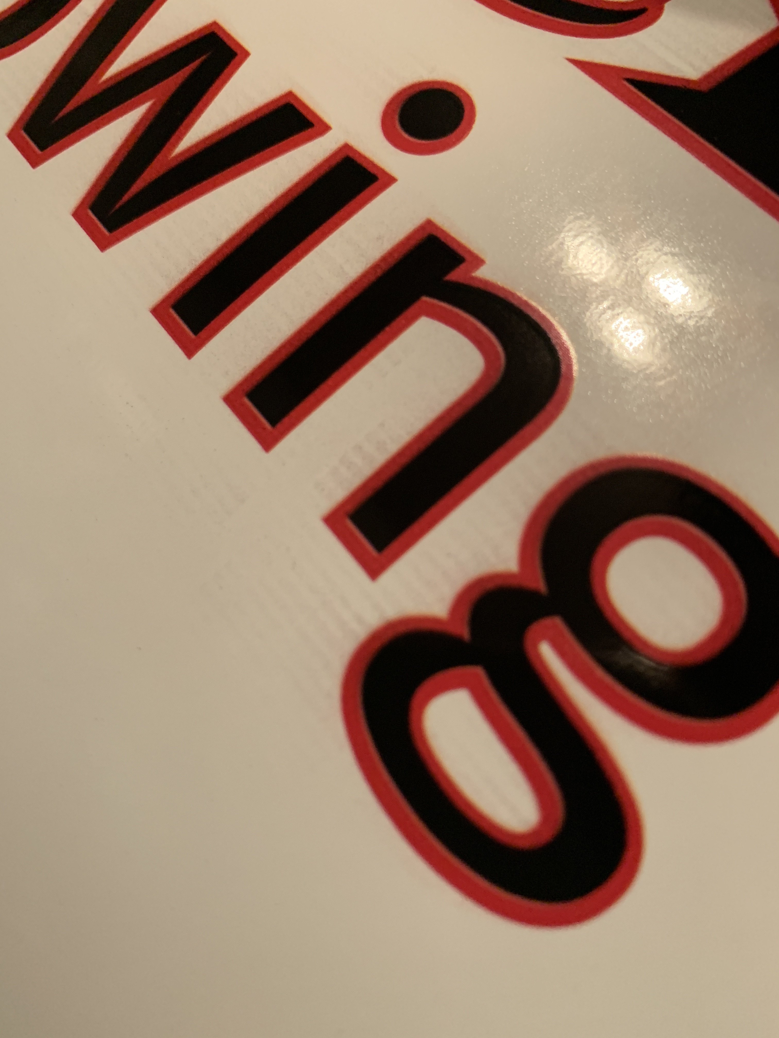

Replaced printhead, maintenance station and cap top beginning of February. I am now getting black in marks when printing. Picture attached of what I am talking about. What could be causing this?

I’m no expert but I’ve had that happen and it was the pinch rollers going against the ink that wasn’t dried lol or having to mess with my feathering option.

I replaced every pinch roller on my 1204. They break down from use, they are a hard plastic type material. There is a lot of them. But when they go bad it does not leave uniform lines like you have but more of smudge marks. I print everything with the head on high and not low.
letterman7
