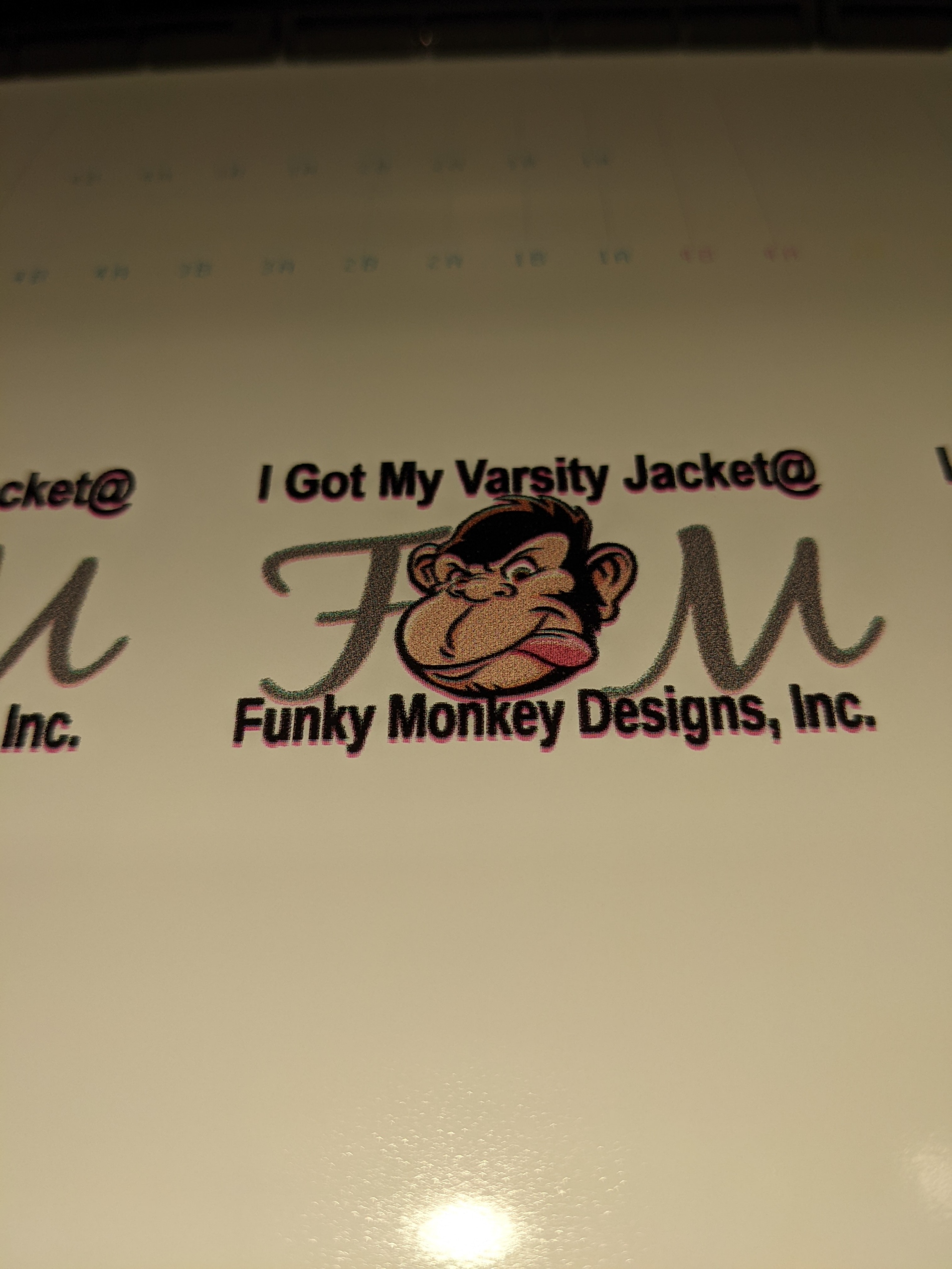

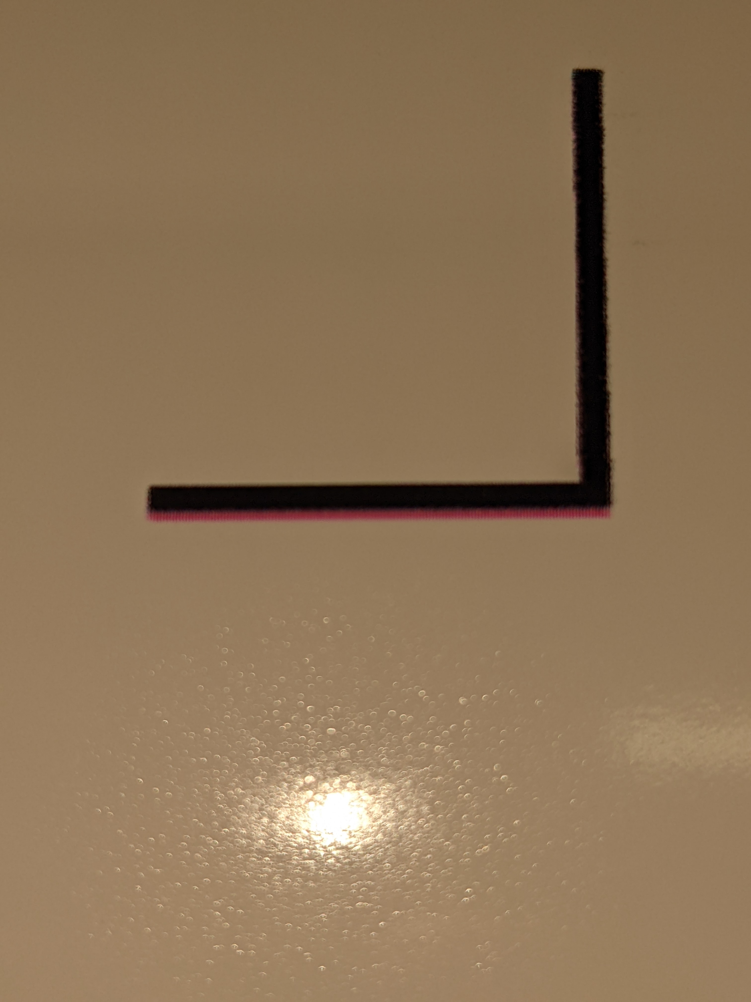

Had some issues with nozzle check not 100%, had to pull the head and flushed with some air. Got it back to 100 but now I get a magenta line under my blacks.
Nozzle check looks good. Wondering if its some sort of alignment issue?
Solventinkjet
DIY Printer Fixing Guide
The head is crooked. You need to go into service mode and run the head slant adjustment. It prints a set of black and magenta lines that you need to make line up using the lever on the right side of the head carriage.
