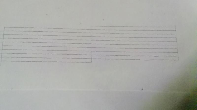

We put it back in, changed the dampers and it turned out that we hadn't seated the head correctly. We managed to seat it correctly my nozzle check now has deflected black nozzles (see attached picture) The rest of the nozzles appear fine but the print quality is real fuzzy. Obviously the head struck something causing the deflected nozzles.
My question: Is there a procedure for realigning the print head after removal, or are the deflected black nozzles causing my fuzzy problems? I realize the deflected nozzles can't be realigned, I’m talking about the entire printhead.
Notes: The attached picture was scanned and darkened to show deflected nozzles. I've soaked the print head in capping station numerous times already.

Stealth Ryder
You will have to soak the Head & Clean until you have a 100% Check Nozzle Pattern... Once you have achieved this you can align the Print Head if needed...
SignAnnex
Does anyone have any tips on how to properly clean the printhead? I've read about filling the capping station with cleaning fluid but it seems to drain out eventually if I don't use a lint free wipe? Also does anyone have insight on the causes of nozzle deflection. Is it ink clogged in the nozzles or are the nozzles actually misdirected? I was under the impression that once deflected, you don’t get them back.
Stealth Ryder
Most commonly caused by dried ink, in most cases caused by not properly cleaning the machine but not always... There are many threads related to this topic...
