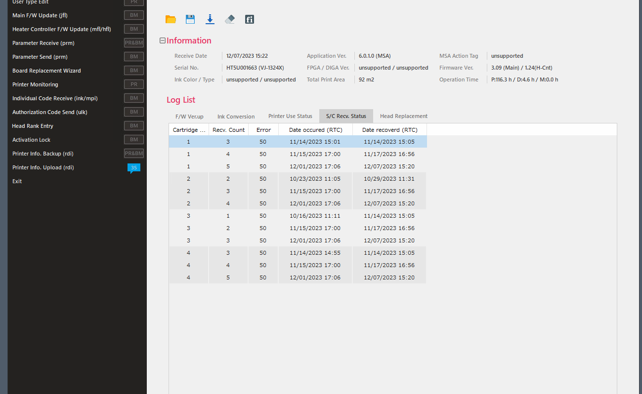

Following up if anyone is interested; errors still persist on this new 1324. It all centers around the chip reader(s), or at least the software that reads them. Mutoh America sent out a Fluke line monitor right before Thanksgiving to see exactly what's happening in the power to the machine. After reviewing - nothing significant showed. A few low voltage spikes on one day that we had a power outage, so that would be expected. But they can't explain why the machine keeps coughing up the errors. Now, Mutoh won't even take my calls or respond to emails. God bless my service tech Chris from GRS being as patient as he can with both me and Mutoh, but Mutoh has basically washed their hands of this machine. There is one error that shows in the service logs that only the techs can access - if we knew what that error was (Mutoh won't say as it's "proprietary") we could make a plan of action to actually fix this thing. Mutoh had me remove all my negative comments from social media in order for me to receive the machine as a replacement and to garner another year warranty.. guess what.. all bets are off with no communication. The absolute worst customer care for a small business and it shows in their Google reviews.

I think I may have an idea of what's going on with this new information. Your firmware version shows 3.09. The latest version for the 1324X is 3.08. I believe you have 1324 non-X firmware installed as the latest firmware for the non-X version is 3.09. That would certainly cause issues. Have your tech try installing the 3.08 firmware. I can't guarantee it works but, it's worth a shot.
letterman7
Not accurate.3.09 has been out since 2/18/2021
Ok.. so if it has the current firmware, that may rule out that issue. From your other posts, you're obviously have experience and contacts with other Mutoh techs. So why does Mutoh corporate want to keep their techs in the dark? Seems counterproductive to me that there are "proprietary" error codes.
