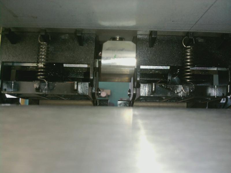

Okay this happens to me all the time. Look slightly to the left of the printing head and there is a little metal piece (kinda looks like a shoehorn) that helps hold the material in place. It will get hung sometimes when you are loading and unloading a lot of material. Just take a weeding tool or screwdriver and push it back to where it needs to be.

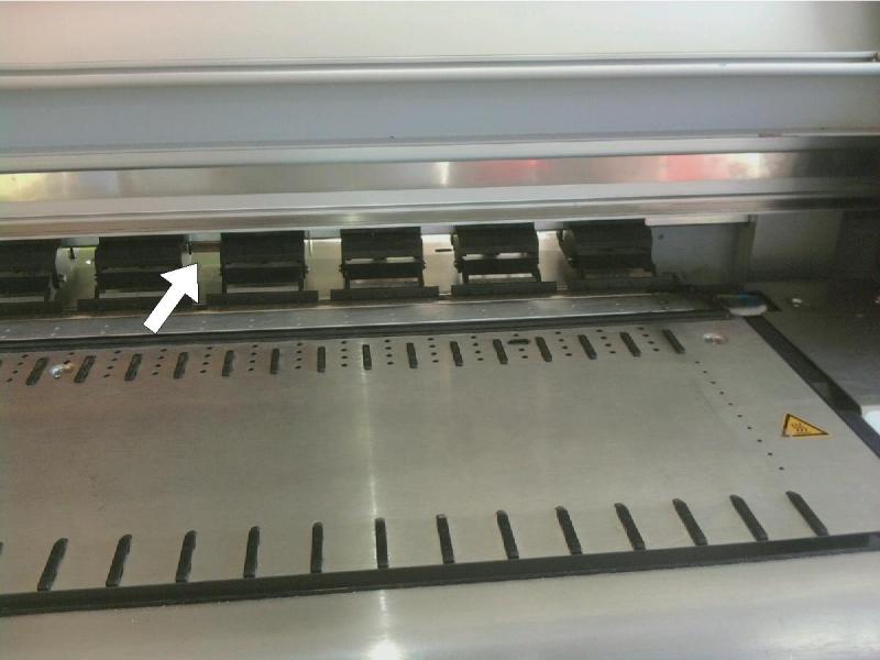

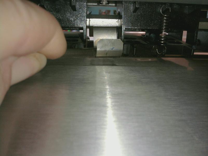

Oh sorry guys, just now saw this again. Okay it is about 8 inches to the left of the print head on the 64" printer.
The first picture is from the front of the machine. The 2nd picture is the piece in the correct postiton taken from the back of the machine.
The third pic is from the back also with me moving the piece down in the incorrect position.

Yeah, I don't see what you are seeing. This is about the ValuJet 1604... Thanks for the pics anyway. But Stealth Ryder is right, my valujet doesn't look like that.

It is indeed a Falcon outdoor. I have never seen a Valuejet in person. Thought they might be similiar. Sorry. I was just trying to help. Hope you get it figured out.
