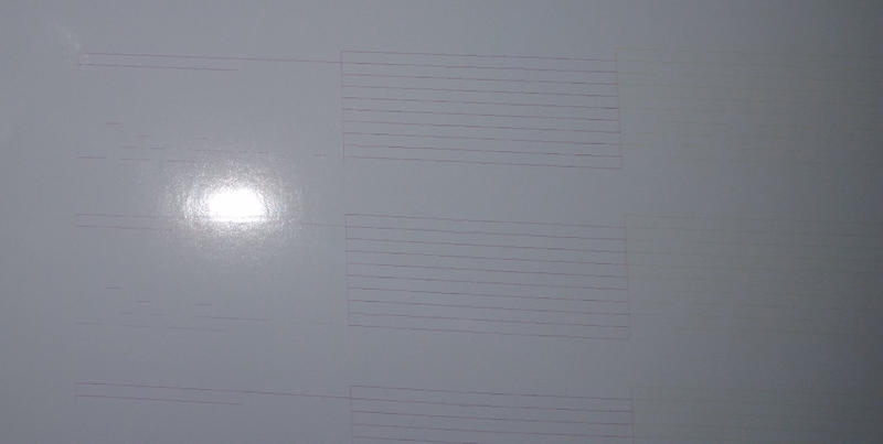

I have attached a nozzle check.. the only part that is not good is the far left one (the last one).
the rest dont look bad.

Fixed it..
The tubes were disconnected from the mt. station..
Thanks Chris for the help..
