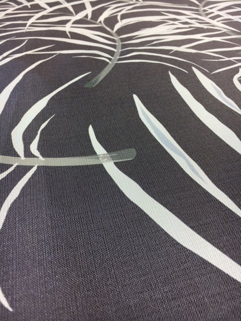

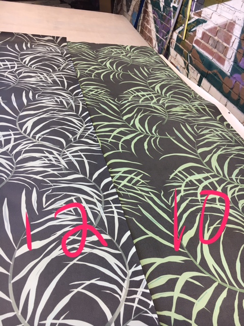

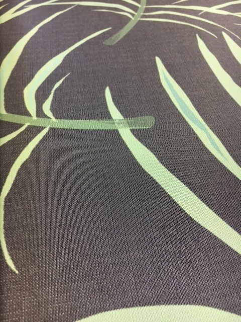

So I'm trying to print this lexjet/york wallcovering material. It's a thick canvas that has a linen texture to it but for some reason I keep getting banding on one side of the material. (the far side away from the "capping station")
So I switched to 12 pass instead of 10 and it helped with the banding but my color came out EXTREMELY different. Actually, it came out less saturated which is odd. The ink saturation is relatively similar with the 10 pass at 110% and the 12 pass at 120%. I'm still getting the banding with the 12 pass but it does look better.
While I was printing the 10 pass I did a feed adjustment on the fly and reduced it from 0 to -2.5 to -5.0 (just to see what would happen) and there wasn't much change. I'm using an ultraflex wallcovering profile.

Asuma01
Changing how many passes the printer does on a premade media profile is 100% your problem imo. Profiles are made with a set # of passes in mind. If you want more passes then you need to rebuild your profile. It's not something you should change or you will experience color shifts. (Yes, sometimes you can get away without any negative drawbacks.)

I understand what you're saying but coming from a solvent world this just makes no sense....more passes....more ink....not LESS DENSITY....
Okay.... so lets say I keep this thing at 10 pass and I already reduced the advanced factor to -5.0 (out of a possible -10.0) - Now what do I do??
Client already approved a color so I have to stick close to that color. I'm using flexi and I don't know how to make custom profiles.

I agree that you wouldn't think that it should behave that way. But there is a lot of stuff going on "under the hood" of a media profile. Sometimes making even what seems like a simple change can have drastic effects.
Just to cover your bases have you switched back to 10 pass to make sure its still printing correctly? There is always a chance that something else went wrong that isn't related to changing it to 12 pass. How old are your print heads? Have you rebooted the computer that runs the rip? Have you checked the color values in the rip to make sure it hasn't changed on the software end? Tried reripping the file under the changed (12pass)profile?
When is the last time you tested/updated your printhead alignment? Don't use the auto alignment, use the manual alignment(hope you have a magnifying glass for that).

- I did go back to the 10 pass and we're still good with that color
- print heads are under 1000ml
- did re rip
- I always do "optimize print quality" when going from vinyl to a textile or different substrate

The number of passes doesn't change the amount of ink dropped, it's not related. It's just gives it more time to dry. It would only change if the profiles are different on ink restrictions and the icc profile.

And FYI more passes does lay more ink, im not sure why other people are saying otherwise.
But it does look like a profile issue that has to do with heat. I wish i could help more but i have 0 experience with that material - i would call the manufacture and ask if they have a profile for latex machines. Either that or play with more of the textile profiles.
