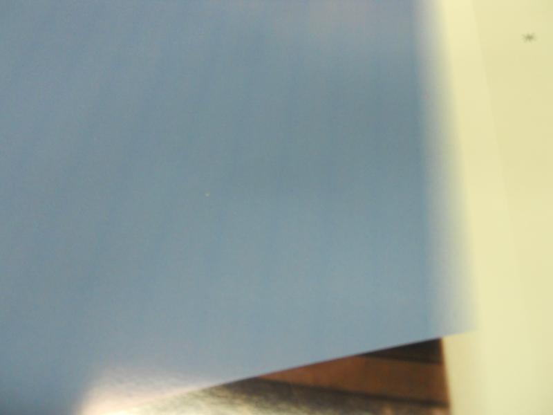

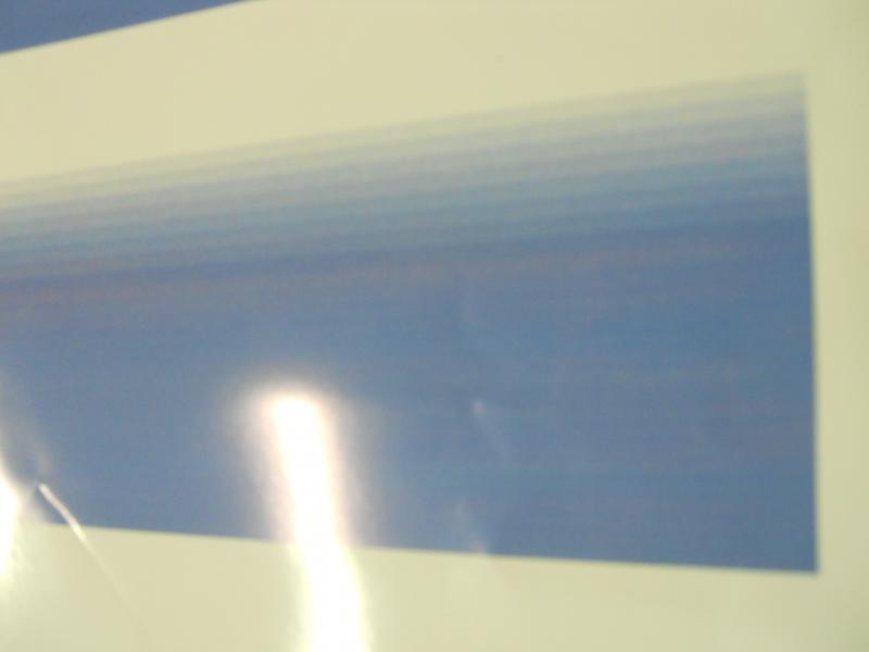

Yes, it's very noticeable in the Cyan, and the job we're printing is a 60 C 40 M 10 Y 0 K background which makes it SUPER noticeable.
I tried my best to get some better shots from our prints the previous 2 days.
Letterbox Mike
yup, that's it... Not to be the bearer of bad news, but I've never heard of anyone finding a solution to that. Thinking about it, I wonder if it has anything to do with the ink too? I'm curious if people running non-OEM ink have the problem or if it's isolated to OEM.
