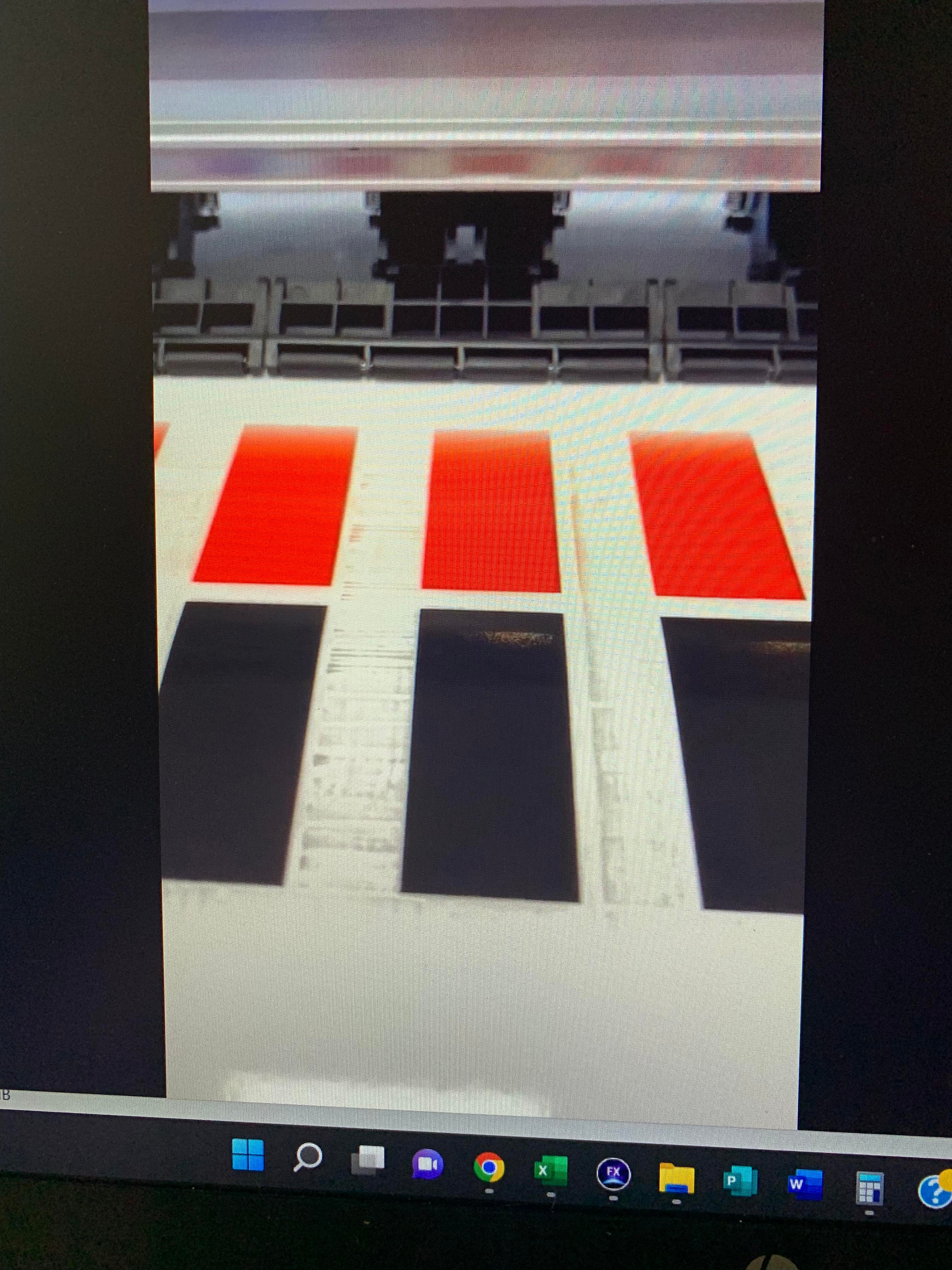

I have 2 Mutoh 1324X both are doing the same.
Ink is landing where the wheels are stopped each pass. 291596200_376722864527170_1544253010727727238_n.jpg
(not on the rollers they are clean.) but ink is landing where the wheels were once under the print head.
They didn't do this at first. Both of these Mutohs have printed beautiful on calendared for several months. They both started this at the same time. I know there has to be a common denominator!

If you run the job in uni-directional mode does it still do it? To me it looks like static causing the ink to drift while it is printing. If the head isn't in the printer level and you switch to a uni-directional print mode it might improve the print quality. The head height changing the pattern also points to an issue with either the levelness of the head or the head height being too high, even in low head height.

probably to simple of a fix...but have you cleaned the pinch rollers. also cheap and quick to just replace them...

I think I've emailed with you about this issue. It's one of those weird issues I see pop up once in a while with these machines and it seems to be hard to troubleshoot. My bet is on static or environment. Whenever the same thing happens to two different machines, it has to have a common cause. So that's either going to be environment, ink, or material. I believe you said it happens on multiple materials so that rules that out. That leaves ink and environment. At the end of the day, if the rollers are clean, the only way I can explain the issue is that ink is spraying for some reason and it's settling in the slight indent the pinch rollers make. Why it's spraying and why that isn't showing up in the test print is what we need to figure out.

If they were cleaned with solvent cleaning fluid that could have backfired. They shouldn't be cleaned with anything harsher than isopropyl alcohol on a swab. Even then, it can take a few feet of material for them to get back to a "dry" state where old ink isn't coming off them. Your situation seems a little more unique than that, but those are definitely wheel marks.
There was another post on here about someone that had cleaned their wheels with normal head cleaner and had to toss them because it degraded/softened them so badly...

Wheels have been cleaned twice with water and swabs. Cleaned them twice. I know it looks like goo wheel marks but when I print red the marks are red, when I print green the marks are green.
The half inch of vinyl that comes out from under the rollers before it goes under the print head is perfectly clean and white.

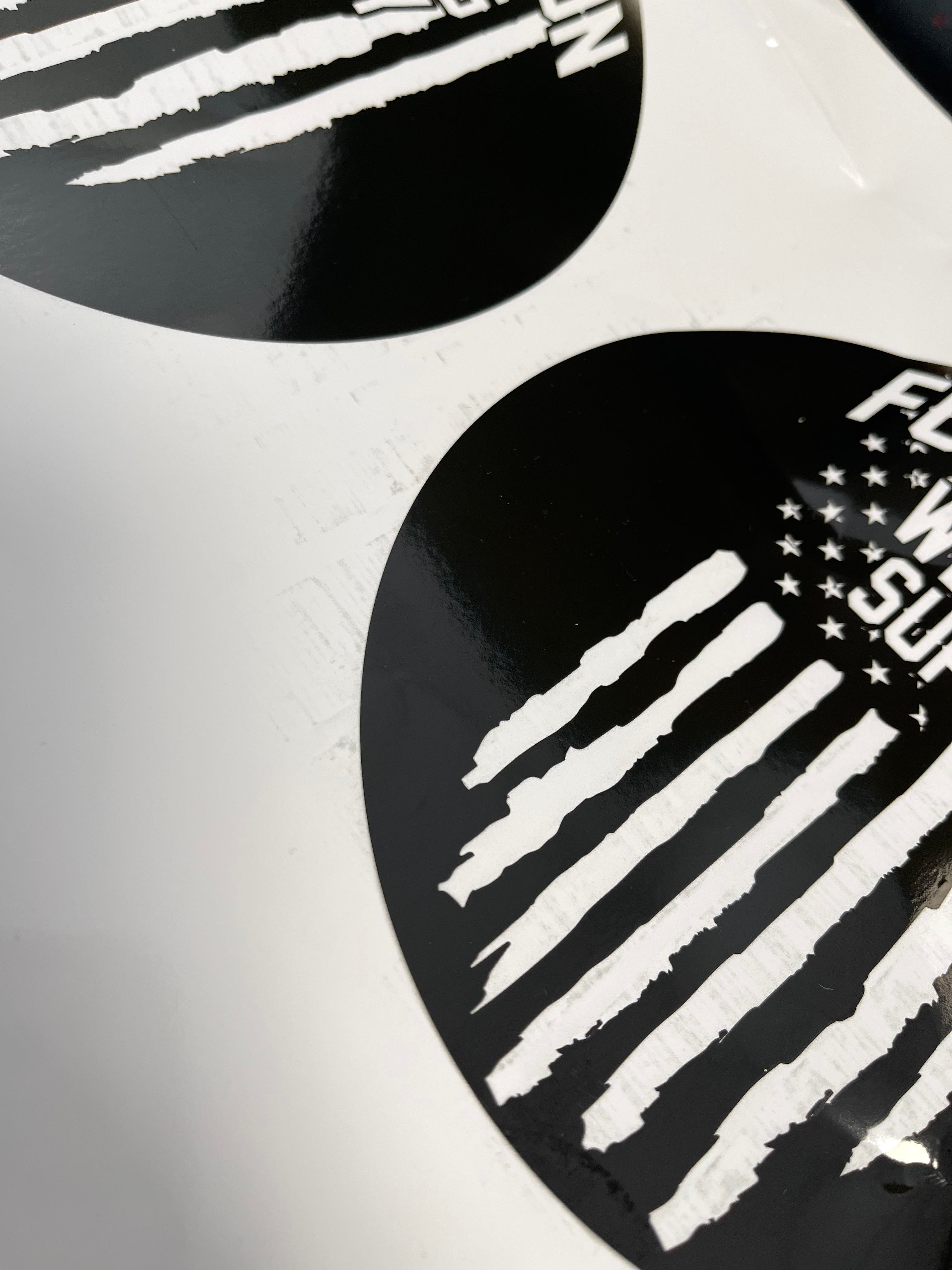

I tried the bidirectional / unidirectional suggestion as per Chris at GRS and got a decent result. Although my 1324 needs a new head, blues, reds, and yellows are printing fine. My black is about 15% out of the printhead. Attached are pics of bidirectional and unidirectional. It seemed to clean up the problem 95%. I am hoping once the printhead and dampers are changed out in a couple of weeks, this will clear up more. It's the original 7 year old printhead. This banding started when I moved it out of the office it was in for 6 years to my garage/office which is quite warmer (75-80 degrees).
