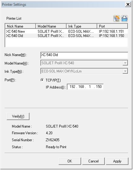

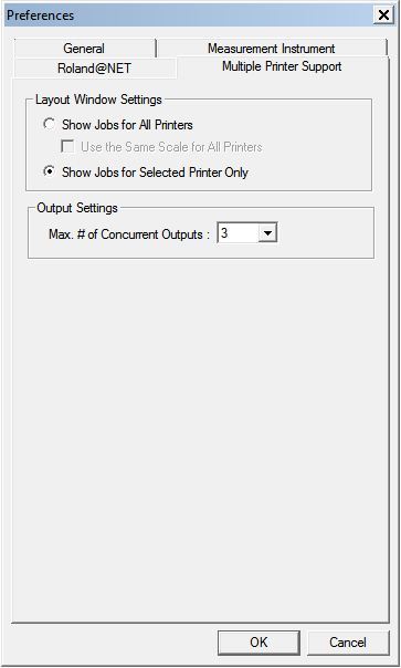

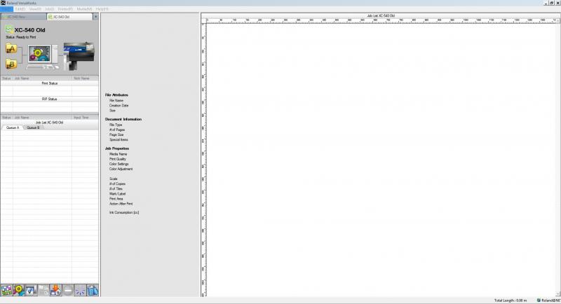

I've had 3 Rolands running off Versaworks previously, 2 over IP and 1 USB. They were all able to print simultaneously. We've since sold one of them in favour of larger HP printers, but I've still got Versaworks installed as a back up for Caldera for the remaining two XC540s. Here's a few screenshots if they're of any help.
