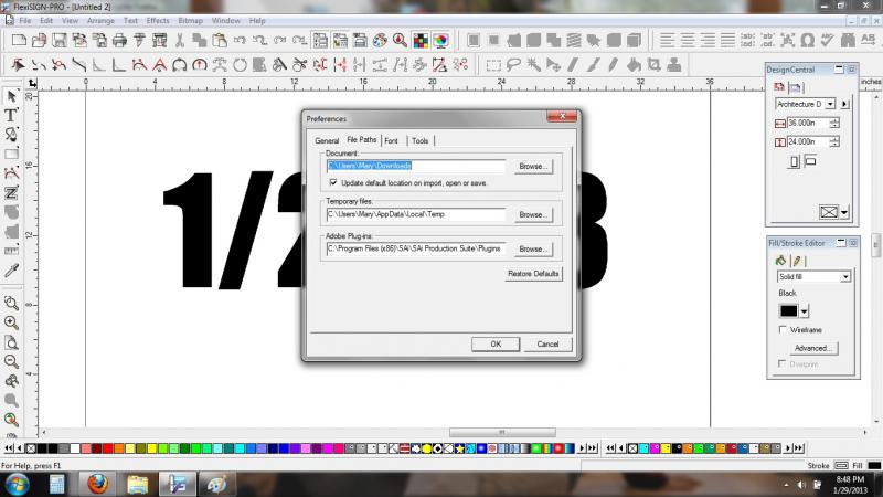

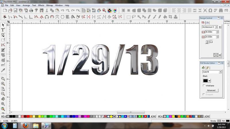

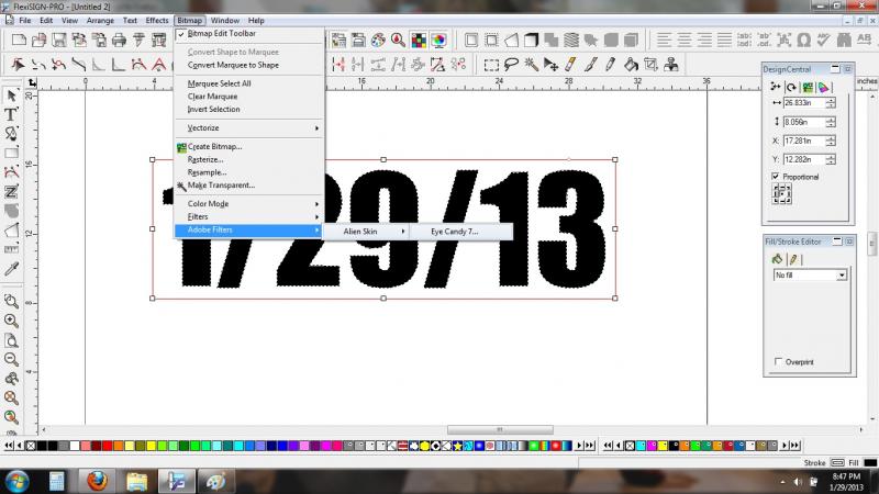

thewvsignguy
I don't have anything photoshop on the two computers I have flexi loaded on, that I know of.
That's odd, I'm running Flexi 10.5 on a i3 with Win7 also and POS laptop with Flexi 10.0 and Win7. Both run the Eye Candy Fine.
