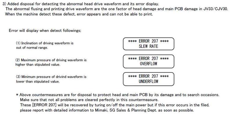

SightLine
I've never seen this one either.... however I did see it mentioned in the release notes for firmware version 4.00. Attached shows what it said although I'm not sure that you will find it very helpful.
