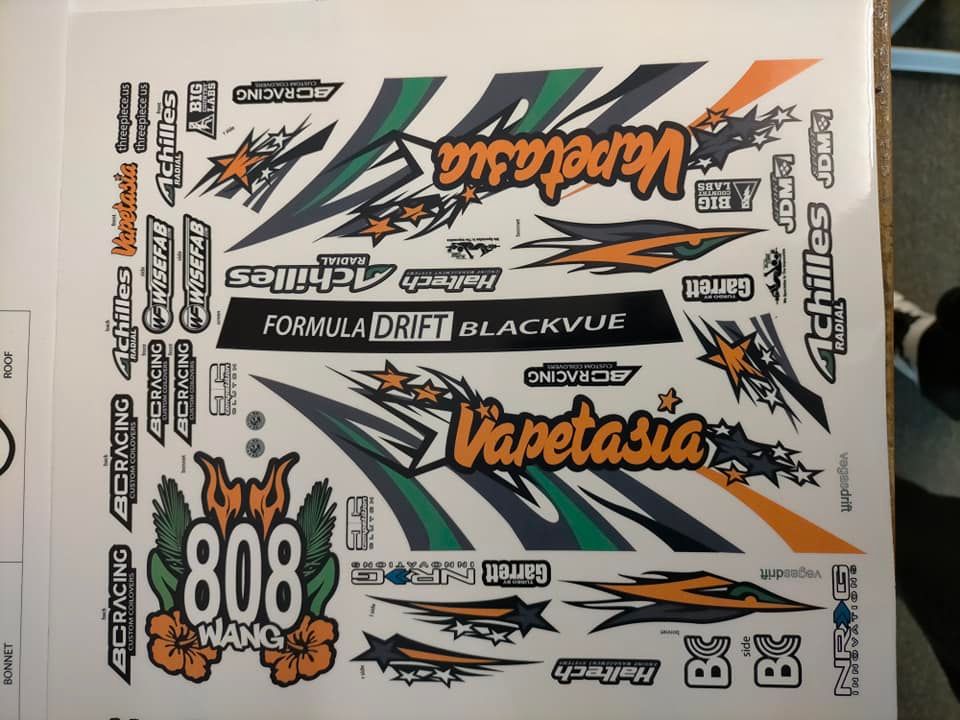

Does such a profile exist for the BN-20?
I print alot of decals for RC models, so use white ink alot.
To get a good white ink you need 2x hit of white ( so far not a problem)
But when it comes to overprinting the CMYK you can forget about returning to origin as the machine just ain't that accurate ( talking about needing to be within .1 of a point)
So I am using my own edited profile where it prints white X2 and followed at the same time with CMYK, slow but gets the job done.
Problem is with X2 white also comes X2 CMYK, so what I have done is edited the amount of CMYK back to around 18/% to get a good colour.
Is there a profile that will lay done X2 white and CMYK at normal levels in the one pass that is colour accurate.
Striving for perfection, as my yellows end up too dark and if I reduce my magenta the Reds are too dull.
Appreciate any help.
