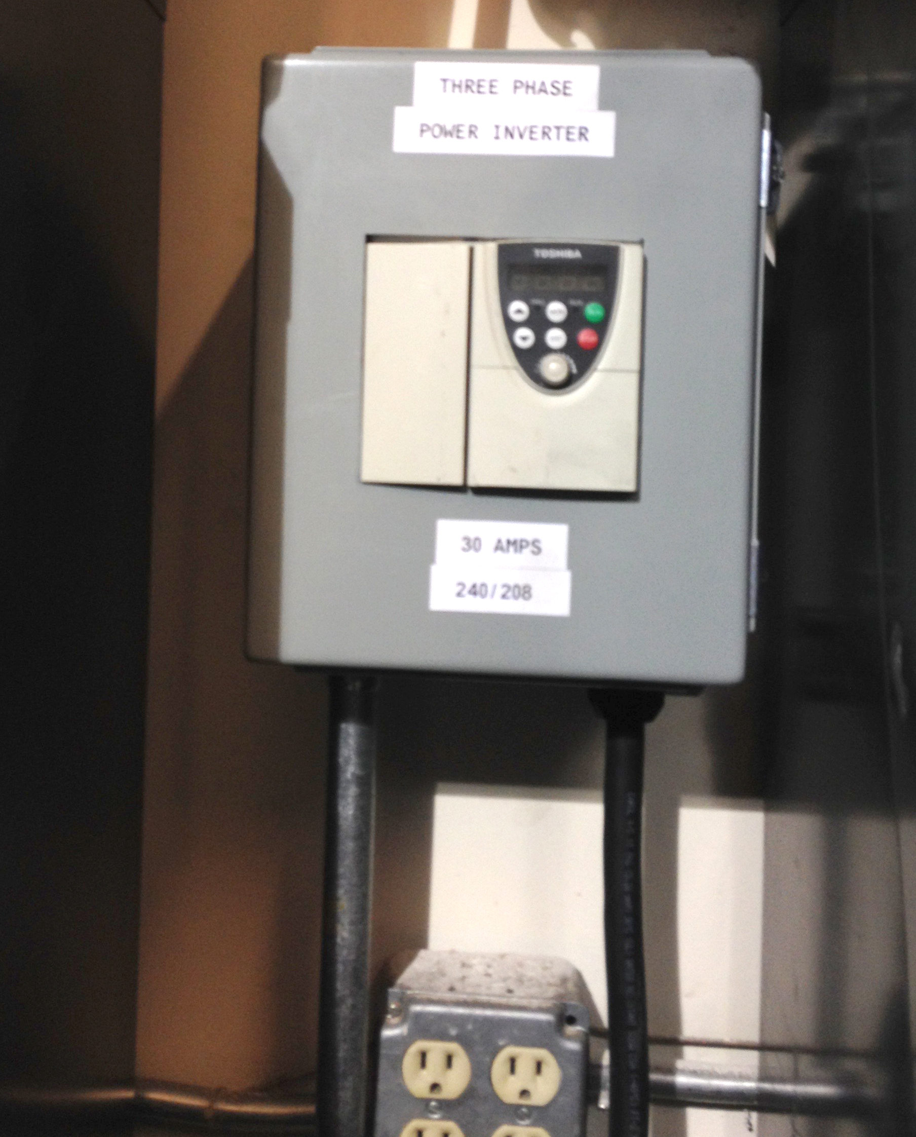

We used a seimens variable frequency drive (vfd). Our electrician explained these were more efficient than older tech converters. So you might look into that.
