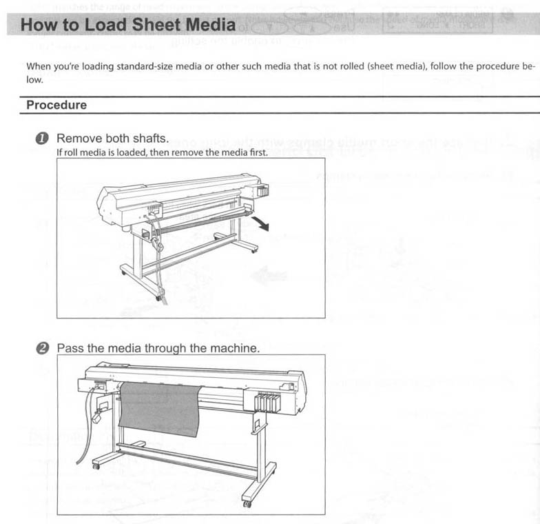

1) In the owner's manual, it says one should remove the rollers if one is just printing a sheet (smaller piece). Is that correct? If so, why? I've printed on a few smaller pieces without removing them with no issue.

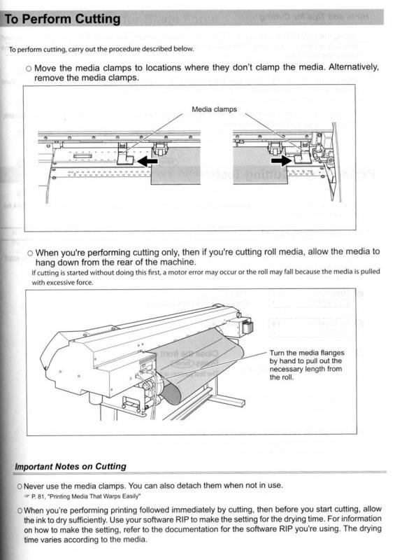

2) In the manual, it also says that the two end media-clamps should never be used when cutting (plotting). a) Why not? I've been doing that for the last few weeks since getting my machine. b) If one is doing a print & cut job, how does one remove the clamps?
Again, media clamps = flat silver things on each end next to pinch rollers ?
I didn't know they came out. I used it that way for the last 6 years.

I guess I didn't make myself clear. The manual is speaking of the rollers (shafts) which hold the media log in the back. It actually instructs to remove them when using sheet media, and I can't figure out why for the life of me.
The tec that set my machine up says that the short clamps can remain in always and the long banner clamps can only be used for banner and when sheet cut is not used. Cutting doesn't come close to hitting the short clamps.
Again, that's not what I mean. I don't mean sheet-cutting, I mean regular vinyl cutting of any kind (with the plotter knife). It says not to do any with the small clamps in place. But I can't see why.
Colin
Here:
Colin
....and here's where it speaks about not using the media clamps when plotting:

I get what you mean now. I generally don't remove the back rollers as outline page 82 of the users manual. It might be due a precaution due to the possibility of the media catching in the rear roller area where it feeds into the rollers and jamming at the back? Sometimes it catches a little and lifts the material up off the bed, but usually falls down before it can catch going into the rollers at the back.
Page 45 refers to the Cutting operation. I have a Summa cutter for cut only operation and never cut material only on the Roland. The Roland wastes to much material to be cost effective as opposed to the Summa Cutter I use for cut only operation(zero waste as opposed to several inches front and back). I also use SignLab 8 as a cutting program on another computer terminal stand alone with the Summa plotter. As a result of this, my tec told me that the during print and cut operation it is acceptable to leave the media clamps in place as the material is already prefeed out during the print operation. Misinformation from my tec? Don't know. Feed jams doing this, never. Cutter crossing the media clamps, never.
Hmmm, yes, I can see how that might be the only issue, but enough to go through the hassle of removing the rollers/shafts? I don't think so.
Yes, I too have another dedicated cutter (a Summa too!) which gets all the vinyl cutting, but the Roland manual seems to suggest that the clamps need to be unemployed for even print & cut jobs. I just don't get that, especially when it starts cutting right after printing!
