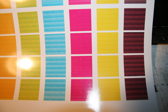

3 yr old 1204 VJ, just started to do this please check out these photos!!
os101king
Switched out to Eleven ten a while back, not sure if this has anything to do with it. Got some screwy banding in last week's run of printing, and the last three or four things I've run have this bleeding out of the cyan that I can't figure out. Any help/advice/suggestions would be very helpful!
Thanks

I always forget how to do the photo posting at first. It's a process black.. I'm going to run a few non-process right now to see if it happens without any cyan in the print.

Just ran a test with six colors.. got MASSIVE bleeding and shadow printing on pure CYAN and the 100% black, none on yellow, none on pure magenta and some on green and purple.....

Lets start from the beginning:
How does the nozzle check look?
High or low head hight?
What media/profile?
Ok. Nozzle check is 100%. Cyan seems totally contained in the tiny lines, no bleeding.
High head height. although I just ran another series of tests and it seems it's greatly decreased with low head height. could this just be a sign of impending doom? I've mistakenly printed on 3 mil and under vinyl with the head set to high, and never encountered this issue.
Tried five or six diff profiles, using an Oracal 3551 with the Mutoh All-In-One profile provided with the printer. 720x720, heater set to 45-45-45, LX diffusion, Graphics 1 settting.
So I guess my question has changed. I think I can get away with printing at low for the time being (little worried about running banners at low..) with the way all these tests look. guess I'm guilty of jumping to conclusions, but hopefully I've uncovered a wear fault BEFORE it's completely ready to give out. At least that's what I'm assuming.
