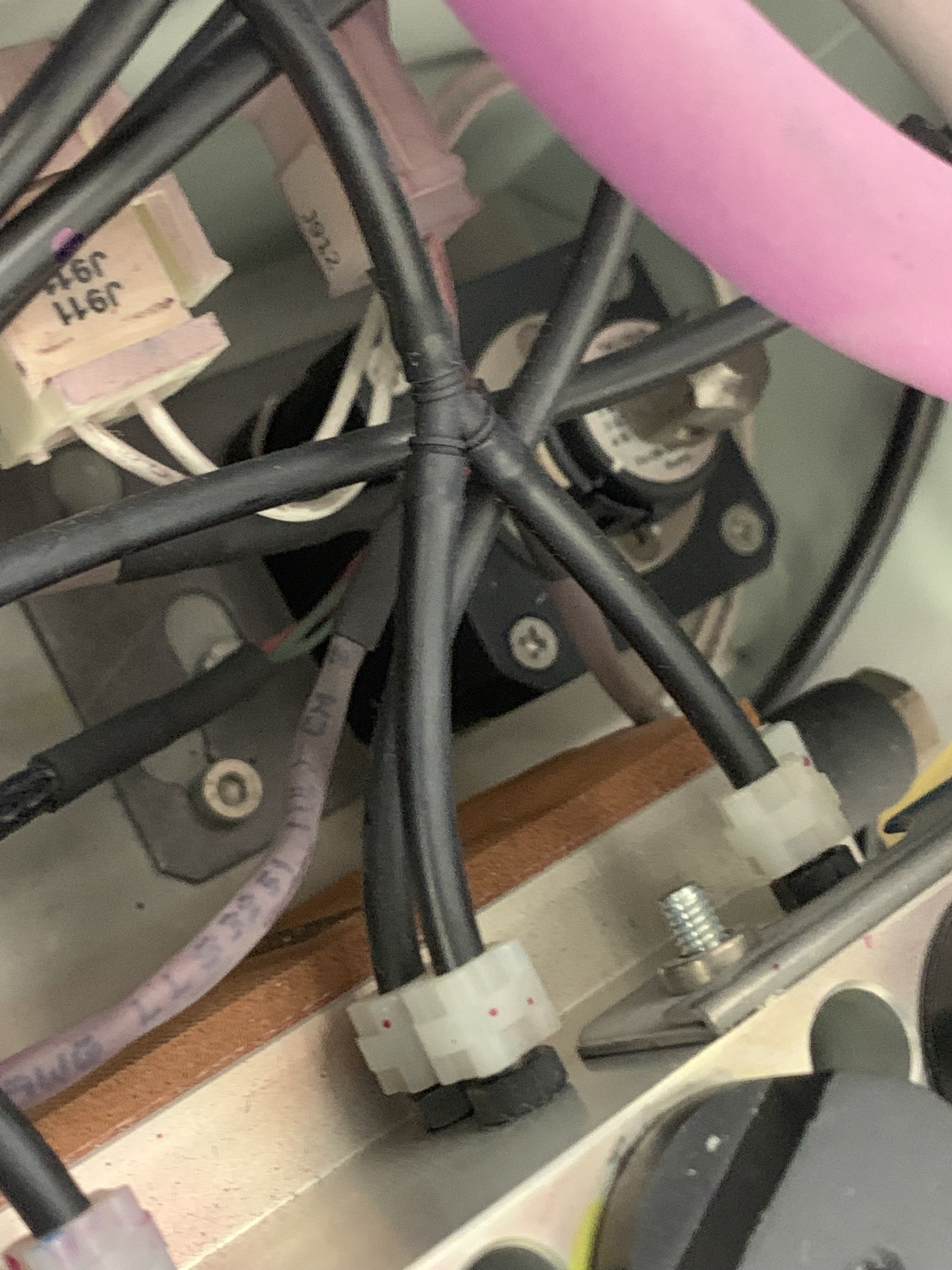

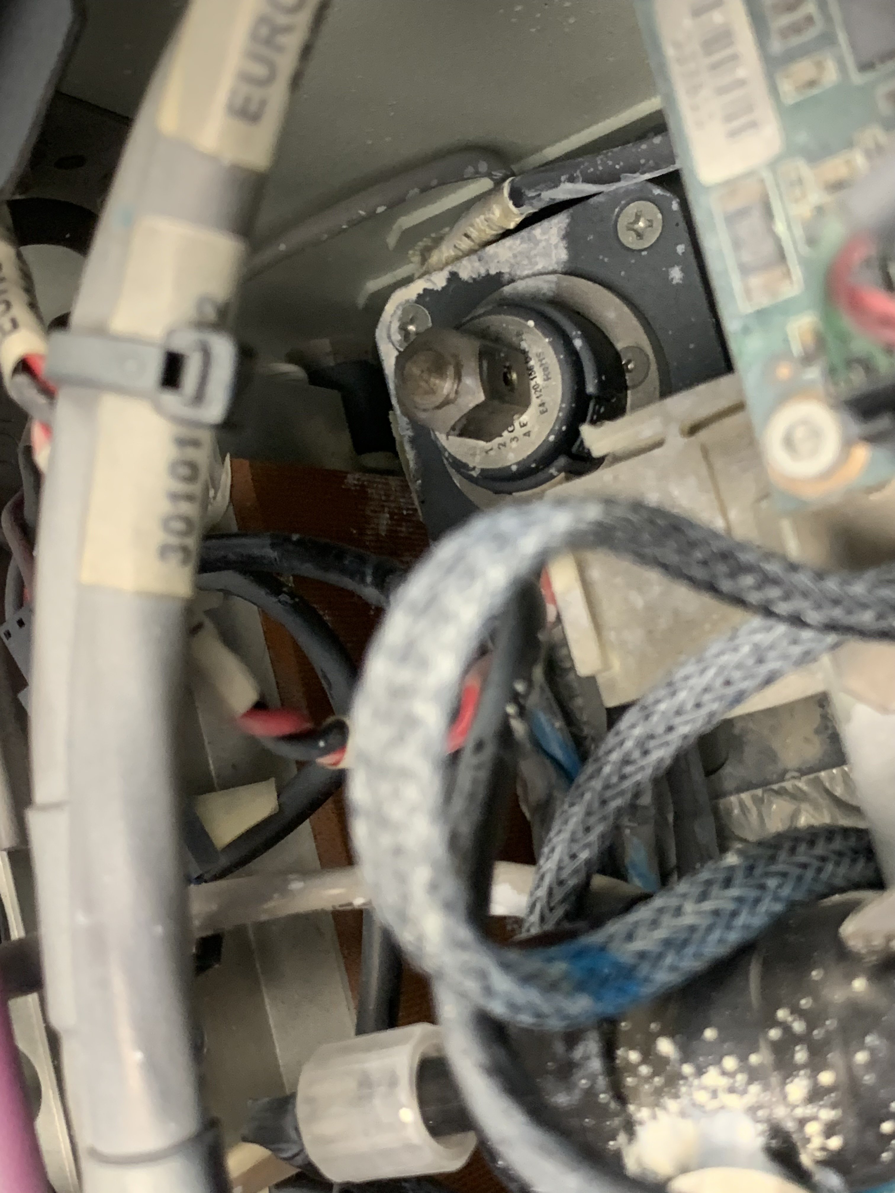

Thanks Peter1313 I am still actively working finding a solution to this machine-
I have manually turned the screws evenly to move the print head up it will, but once you start it moves the head down then brings the error back. I only tried this because of the error no reason to ever do it prior. Not sure about tyhe shaft housing, I want to dismantle myself and check but am afraid to mess up the machine especcially without a technicians manual or technician.

In theory (when the printer works properly) during the initialization printer should raise the carriage to the maximum, level it (on the basis of both encoders readings) and then lower toe carriage to the home position. If your printer makes an error during the initialization, that may suggest the following reasons for the problem:
- one of the Z-axis encoders is damaged
- one of the Z-axis motors is damaged
- one of the plastic elements (mounting bracket) connecting the Z-axis motor shaft with the carriage is damaged
- something is wrong with the Z-axis driver board (is there any chance that jumpers located on this board are in the wrong positions?)
Unfortunately, you would require the SDS key to enter the service part of the firmware and check readings from both encoders. The printer uses only them to verify the position of the carriage, if anything is wrong, an error appears (physical position doesn't matter, carriage may be perfectly levelled with different values on both encoders and that will create an error). I'm afraid, that without the SDS it will be difficult to diagnose the error.

Where is no encoder? In the Z-axis (carriage height)? Indeed - there are two encoders, but not linear. They are integrated with the Z-axis motors (located at the top of the motor). Each Z-axis motor has two cable connections - one is for the power (to the PBA Z-axis motor driver) and another one is the encoder (to the PBA carriage boards, connectors J103 (left) and J104 (right)). In the SDS it's possible to read values from each Z encoder. When the carriage is going up or down, values from both Z-axis encoders are compared and in case the difference is too big, a Z-axis error appears. Why values are different, is another story - it may be a damaged motor, damaged encoder, damaged plastic support on the Z-axis motor shaft, or damaged PBA carriage board (and it's not all...).

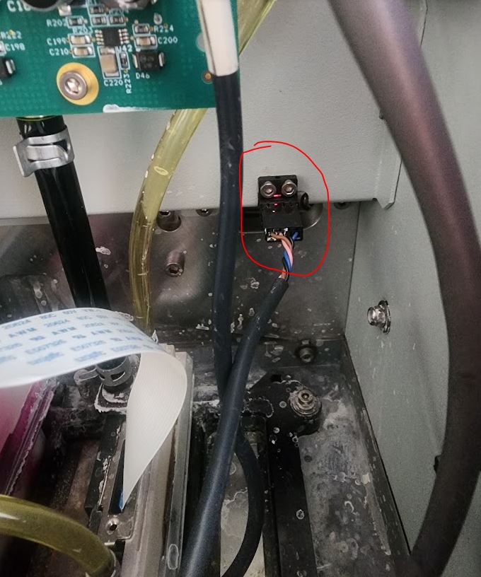

I had this exact issue on my 350GT 2 weeks ago. It is a faulty encoder. Attached image, as mentioned above the light should be red. Unplug + unscrew it and give it a good clean. Try swapping sides (there is one on each side of the carraige) to see if its the cable or the encoder. Mine was caused by a coolant leak dripping on the encoder, a clean with some iso + dry with low heat gun got it going again. I also ordered one from Digiprint, https://www.digiprint-supplies.com/en/arizona-250-gt-sensor-optical-z-axis
