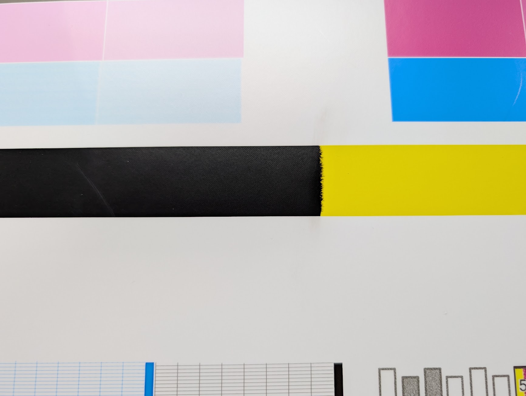

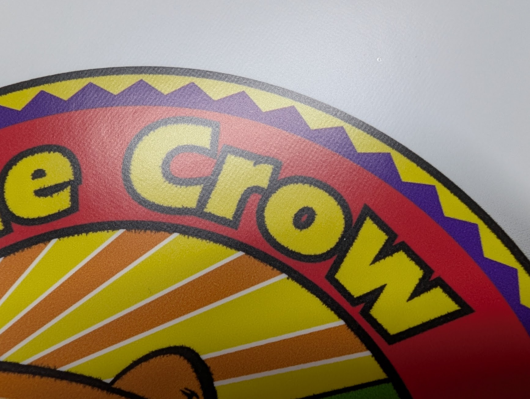

365, Black is bleeding into the surrounding colors, any ideas?
Increase the amount of Optimizer (at the front panel under Substrate Library...Media...Print Mode). Also check the performance of the Optimizer printhead (#1), clean as necessary, and potentially replace it if needed.
Reactions: 1 users
Kernersville Vinyl

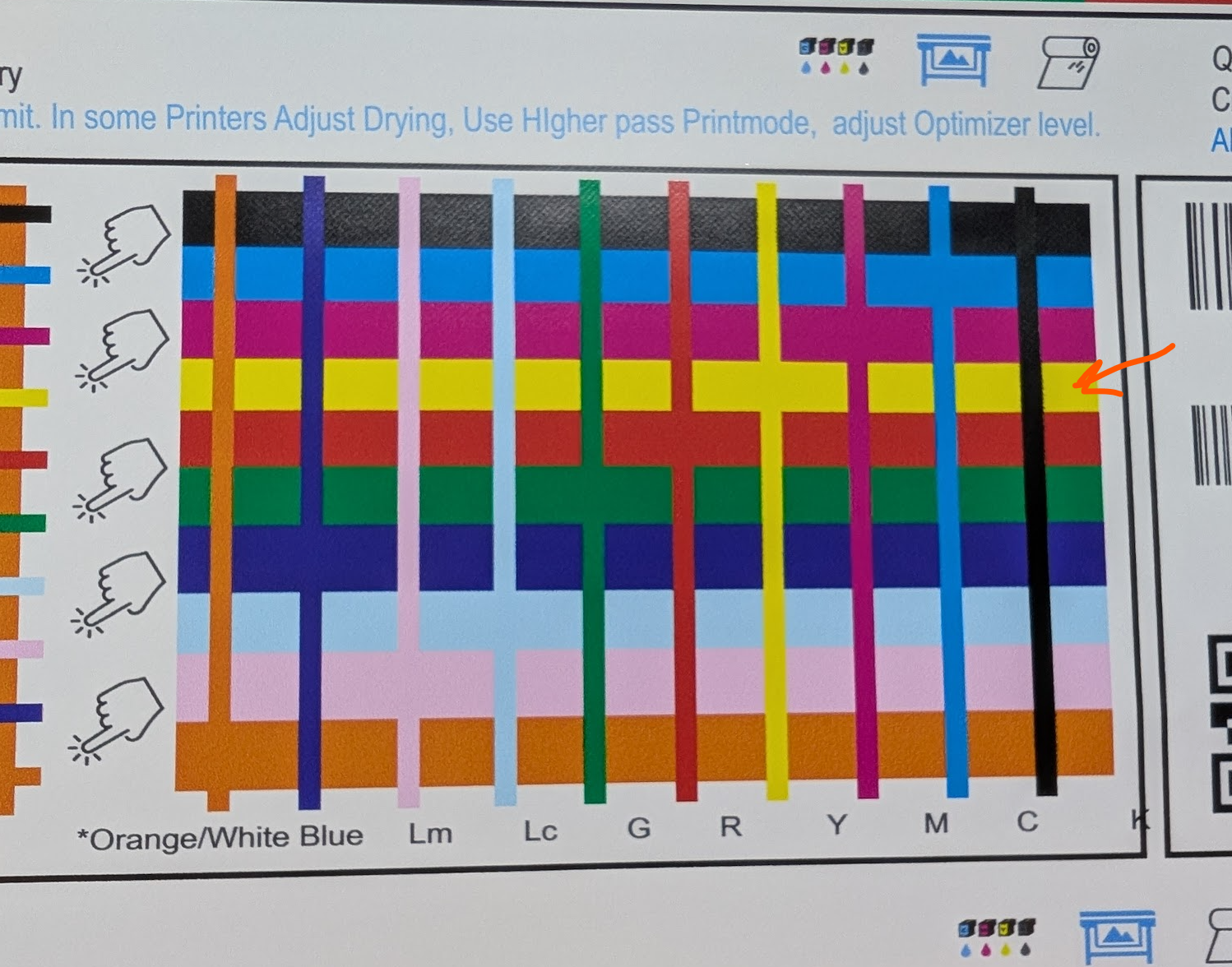

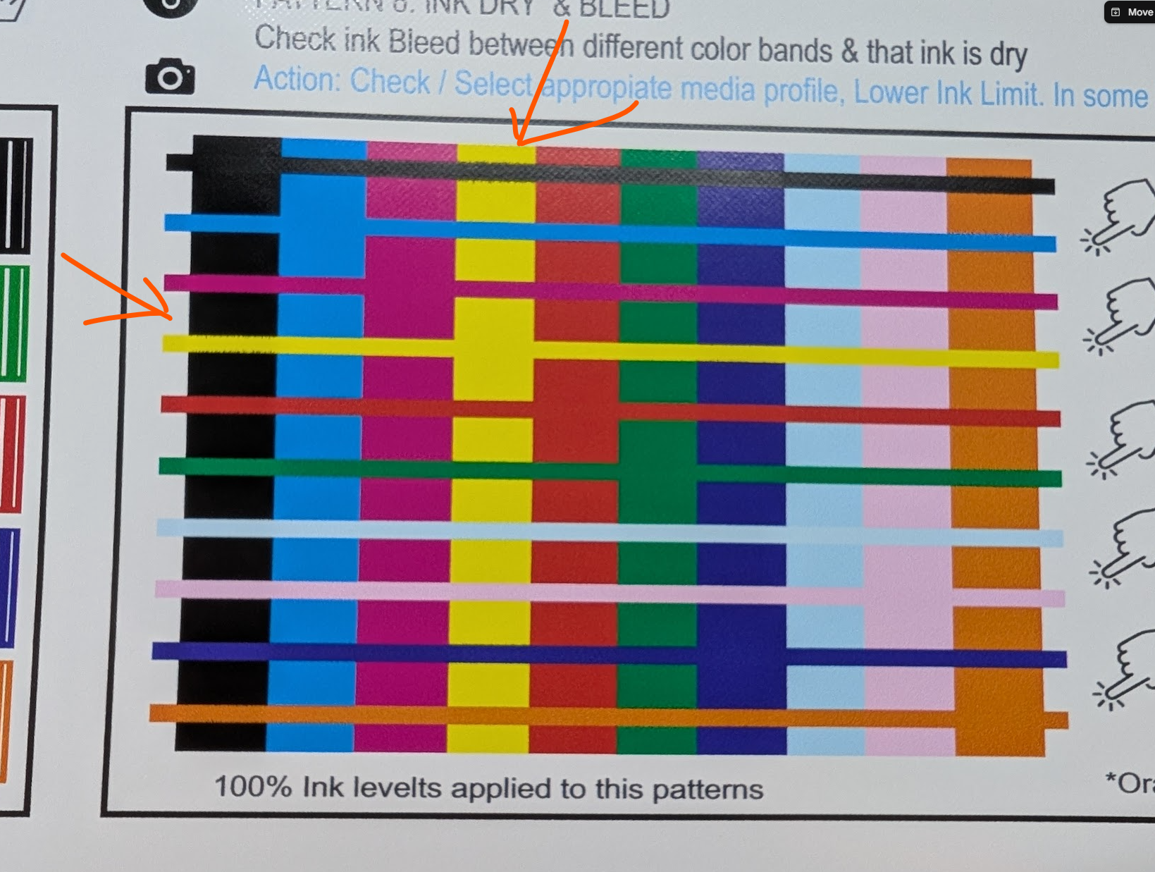

I did replace the optimizer printhead and it is a lot less, but still not 100%, noticeable where the black and yellow touch each other, all printheads changed except one MAG/YEL and one CY/BL
Increase OP level in 6-8 percent increments in the print mode that you are using when printing to this smooth banner media.
The other option would be to print using a lower ink density, but this could decrease color gamut.
balstestrat
Problem Solver
I would rather increase interpass delay. Keep optimizer around 20.
It's probably difficult coating on the material.
JBurton
Signtologist
Can you confirm it's not a reverse wound roll, like ultraflex? It will definitely receive ink, it will just look trashy.
