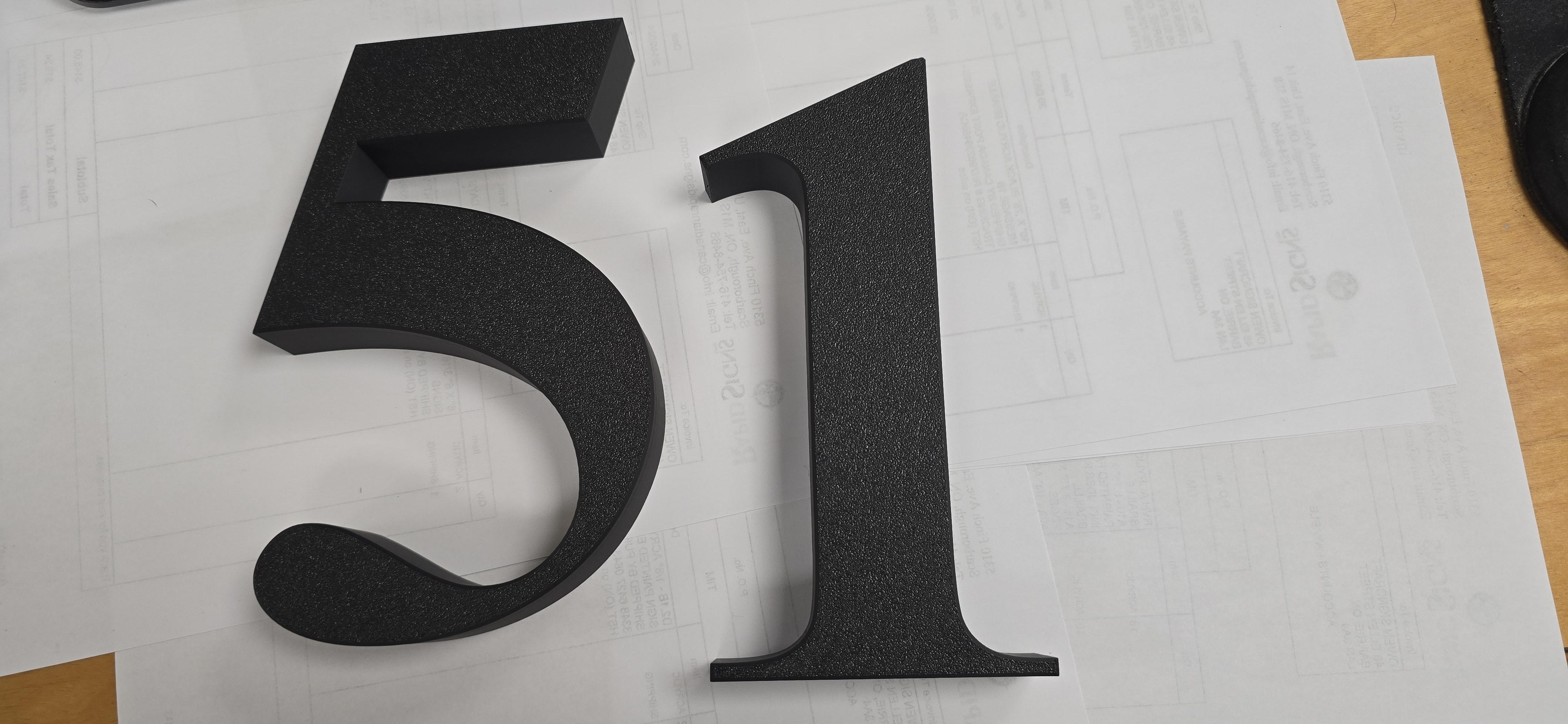

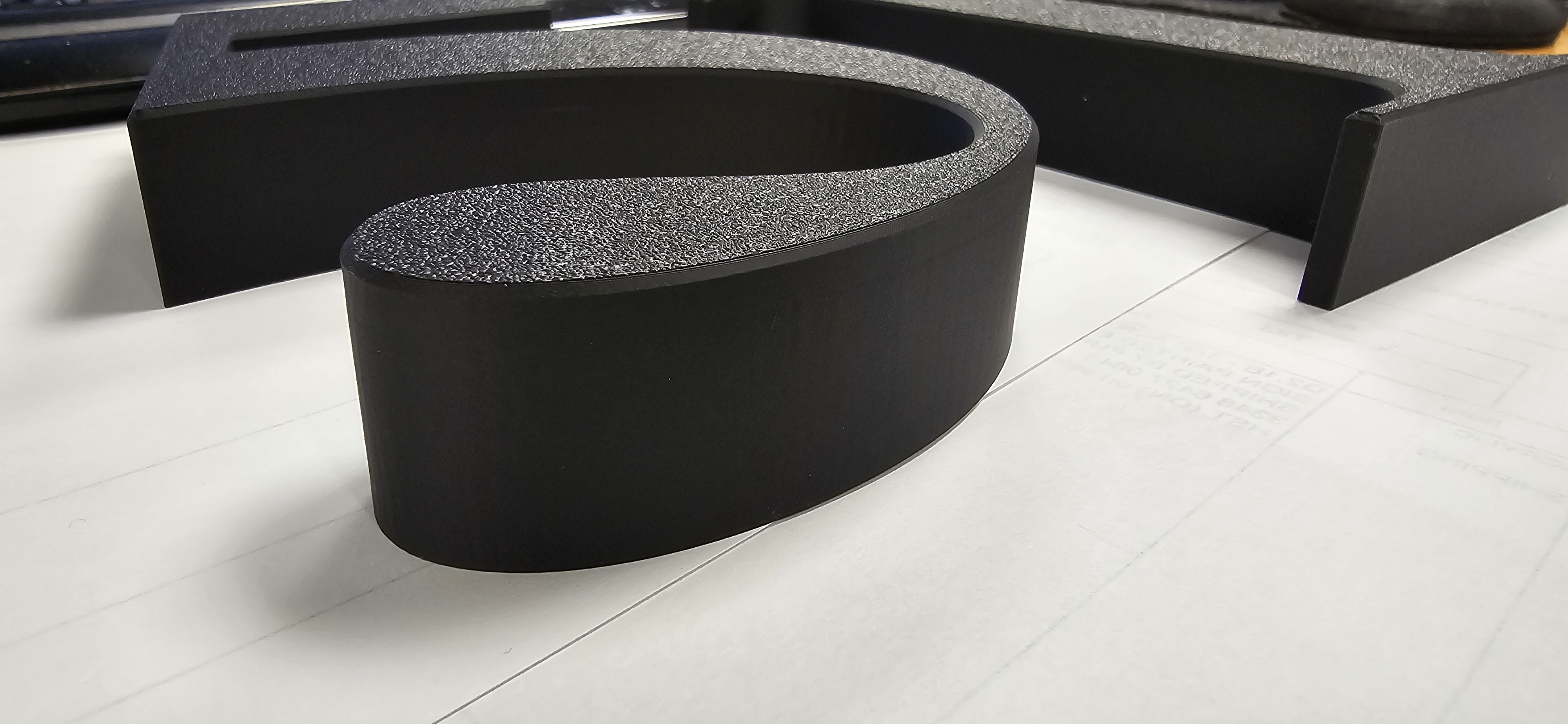

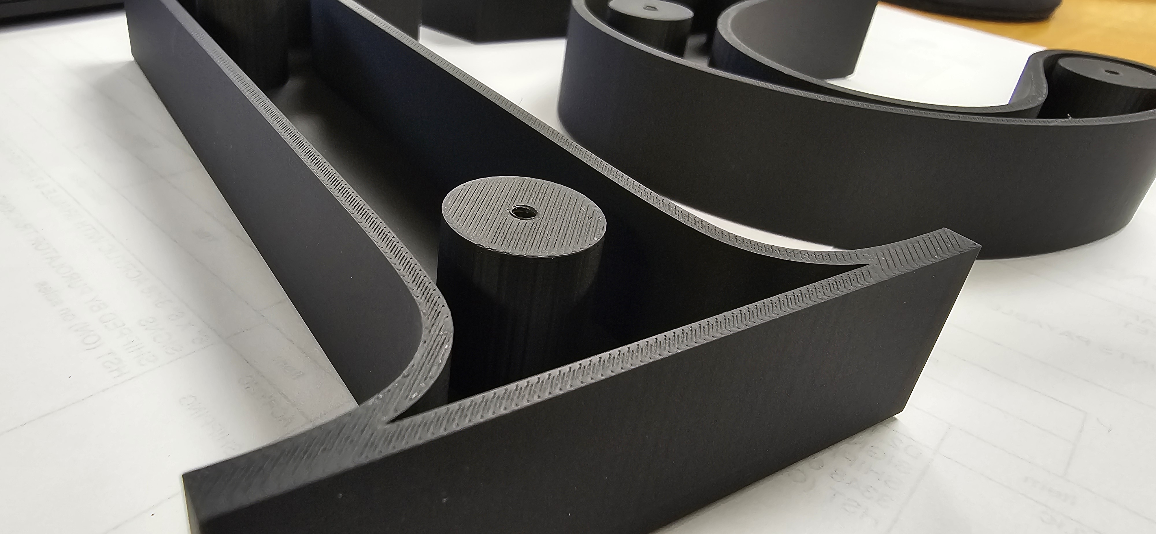

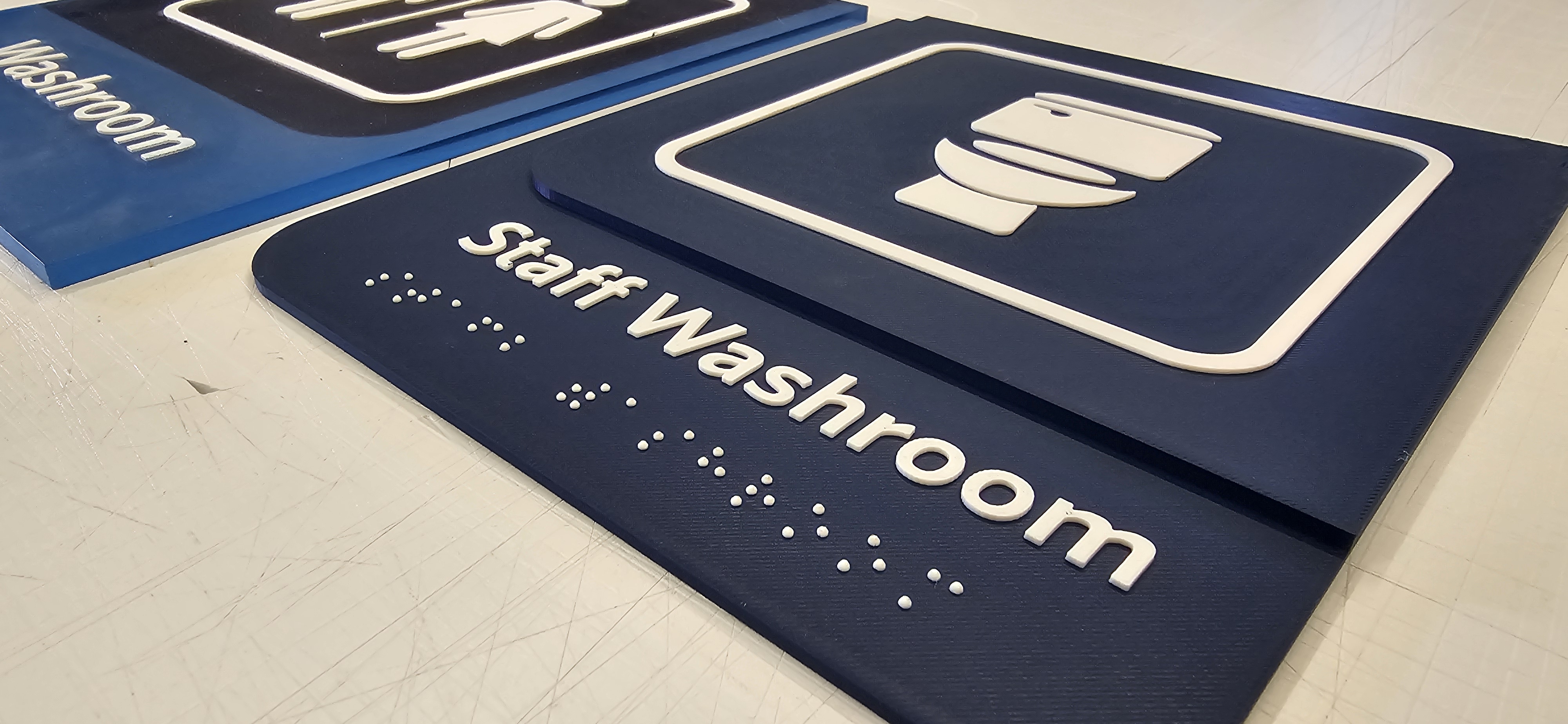

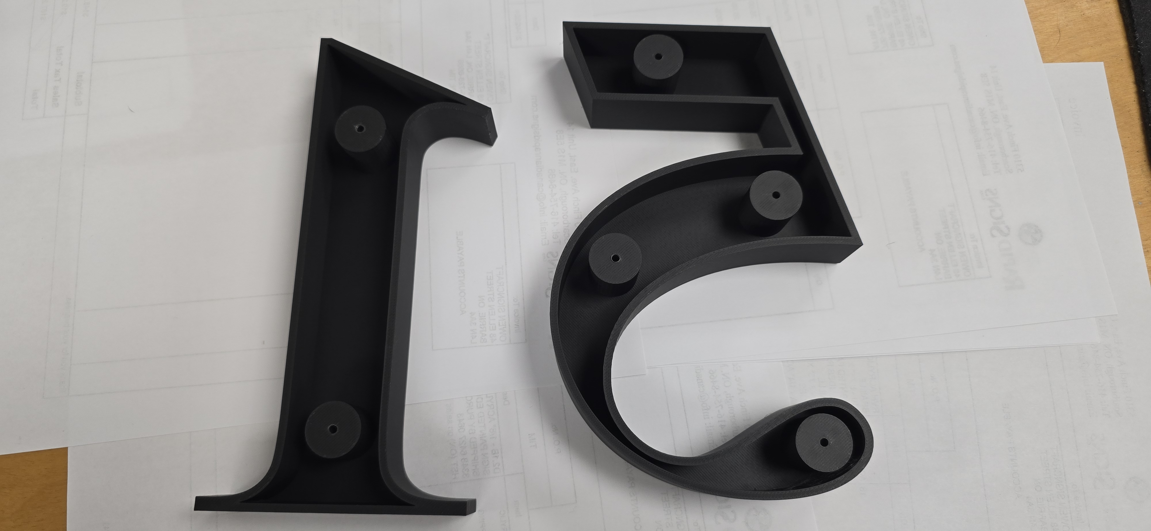

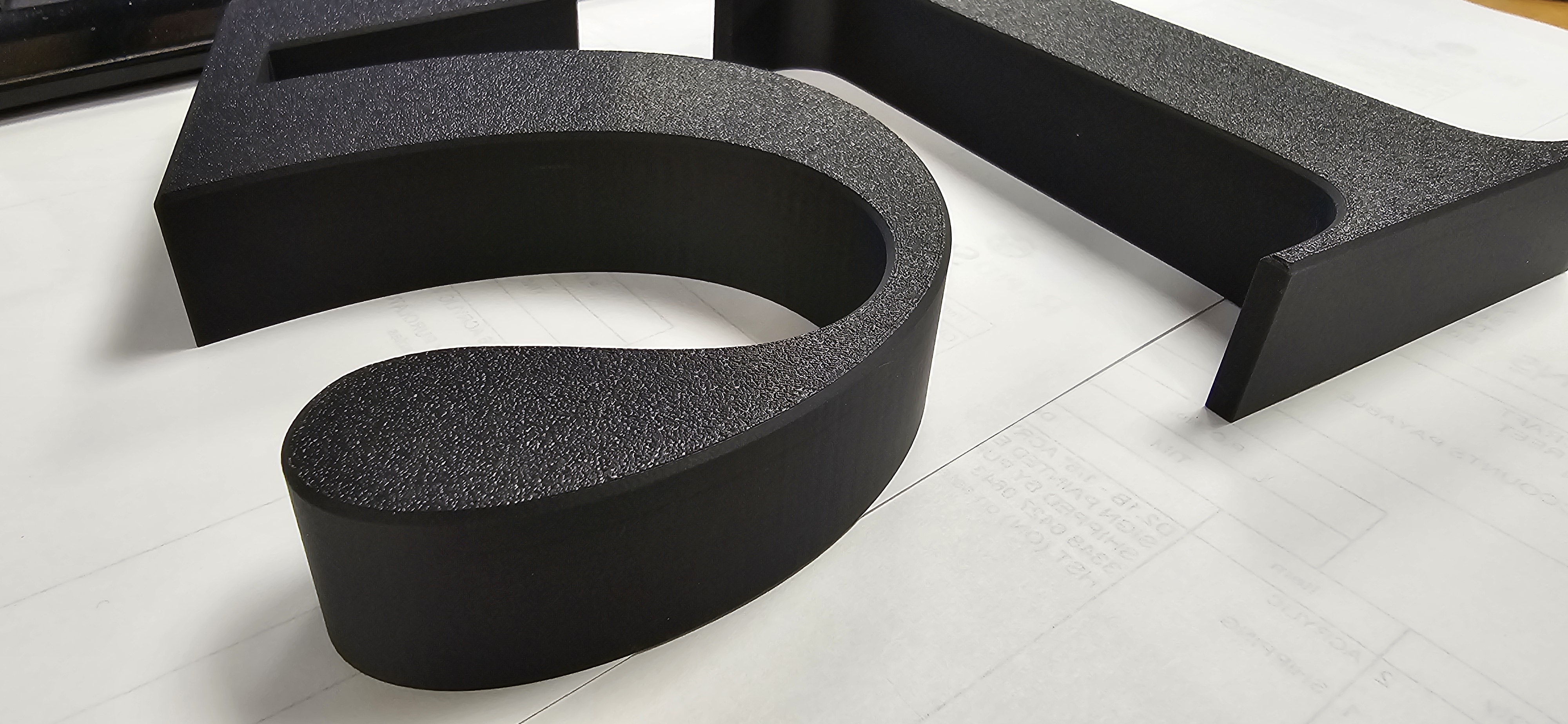

Anyone else printing dimensional letters and signage? Wondering what kind of success you are having. One interesting fact we are noticing is is the final material cost. The attached 7" tall letter at 1" depth used $4.50 CDN worth of filament to produce (add another $1.25 to cover machine costs over 5 year) Compare that to a Gemini 7" formed letter at 3/4" depth for $14.71 cost which has a retail price of $46.70.

Have to be careful what filament you use, some don't like to get too warm, like PLA. It'll warp in the Texas sun. Also has to be structurally sound to take a screw like that. What kind of filament was this?

This is a matte PLA test for indoor letters. The bosses are for pin-mounts, not screws. For outdoors we understand that an ASA or ABS should be used for both temperature swings and UV stability. Haven't tested those yet but looking forward to it. We are also trying some tactile signage options (attached). Looks promising so far. Especially for braille.

Textured surface would likely be non compliant, but you can get around it by purchasing ada compliant materials for the 'panels', as printing that area is the most time consuming part anyways.

As a word of warning, 3D printed text and braille are not compatible with laminate sign faces. They fail very quickly, at least in my experience. Although if anyone has a solution that would be great to learn.
