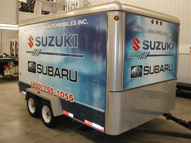

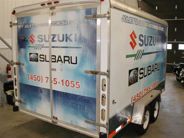

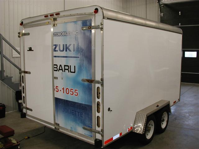

A good customer of mine had this distressed trailer to revamp. I did it 10 years ago but last year someone washed it with very aggressive cleaner and ruined the job. Anyway, he had decided to "divorce" with Suzuki so the occasion was perfect to take it out of the picture... So the owner asked me to remove the old wrap and do something simple, clean. I decided I wouldn't ripped my heart out trying to get rid of this "baked" graphic so I opted for a total cover-up.
The 1080-G10 was the perfect film for this job but also the only option. 3M is the only brand with tinted adhesive to turn white into opaque one, all other brands have clear adhesive so everything bleed throught. 3M should really shout it out loud into their marketing for the 1080 !!!

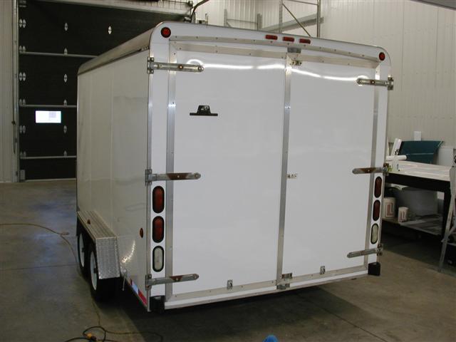

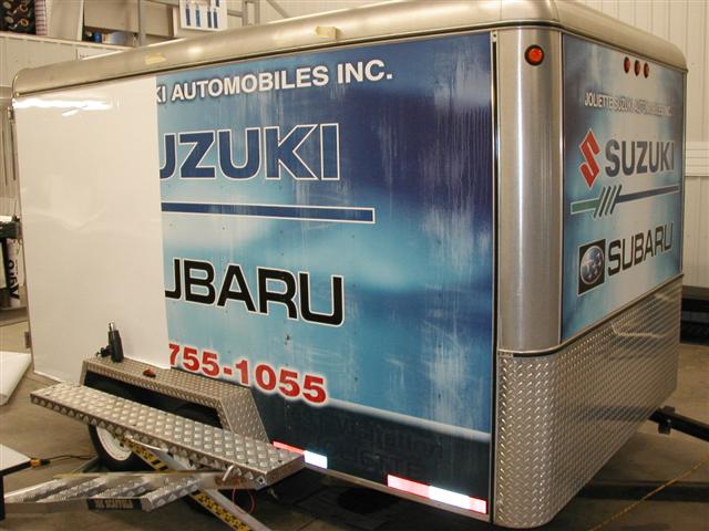

I easily covered-up the whole box first and then I've printed graphics / cut letters separately so the day the guy will want to sell it, it can be turned back to virgin state w/o breaking a sweat.

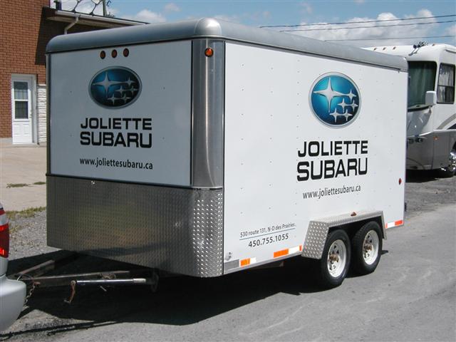

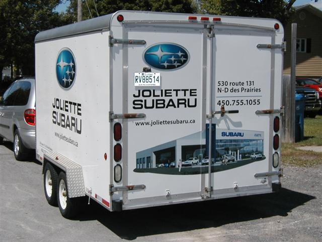

Here's the trailer outside with new graphics. Sure the old one had more impact but client's request was simple & clean so I listened...

Nice job...BUT your saying the old wrap is still on the trailer? Im not saying anything is right or wrong its whichever you and the customer choose but wouldnt the right thing to do is peel the old one off first and just letter the trailer? Now potential buyers wont see the aluminum surface condition of the trailer? Did you try a section of the trailer to see how bad it really would have been? By the pictures looks like it woulda been pretty bad but just curious what it would have took to get it off.
Patentagosse
I didn't have the time and didn't wanna get my fingers to the blood trying it. I work alone here and there's no money to get me remove old baked vinyl...

Couple of mistakes.
1. Wrapped over the old vinyl? Worse idea.. if your old bottom level fails.. your new level fails.
2. You're putting the panels on backwards. Now the wind can easily get under them, and left them since they're going the direction of which you drive....
overall for what it is, nice job.

Couple of mistakes.
I think you were looking at the photo wrong. He started at the rear of the trailer with the first panel, which is the correct way to overlap.

HulkSmash
oops, i thought that was the front, you're right
