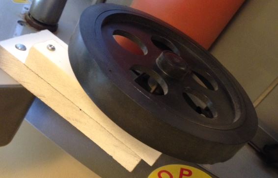

rjssigns
I had short 3M rolls a couple times. That's why I rigged a counter on my laminator. No more guessing what the total length was or if there is enough remaining to finish the job.;)

JP4
Counter! Yes! Great Idea. Any chance you would share your design? Send to jp@opgfx.com
Thx!

stew1tx
Centex Wraps and Signs
I second wondering if you would share the design? brian@ centexwrapsnsigns.com

rjssigns
Laminate Measuring Device. Ain't much to look at. Harbor Freight measuring wheel Item [HASHTAG]#95701[/HASHTAG] and some scrap Apex board. Laminator is an RS-1650C
I should get a patent:D
Really surprised manufacturers don't include one.
