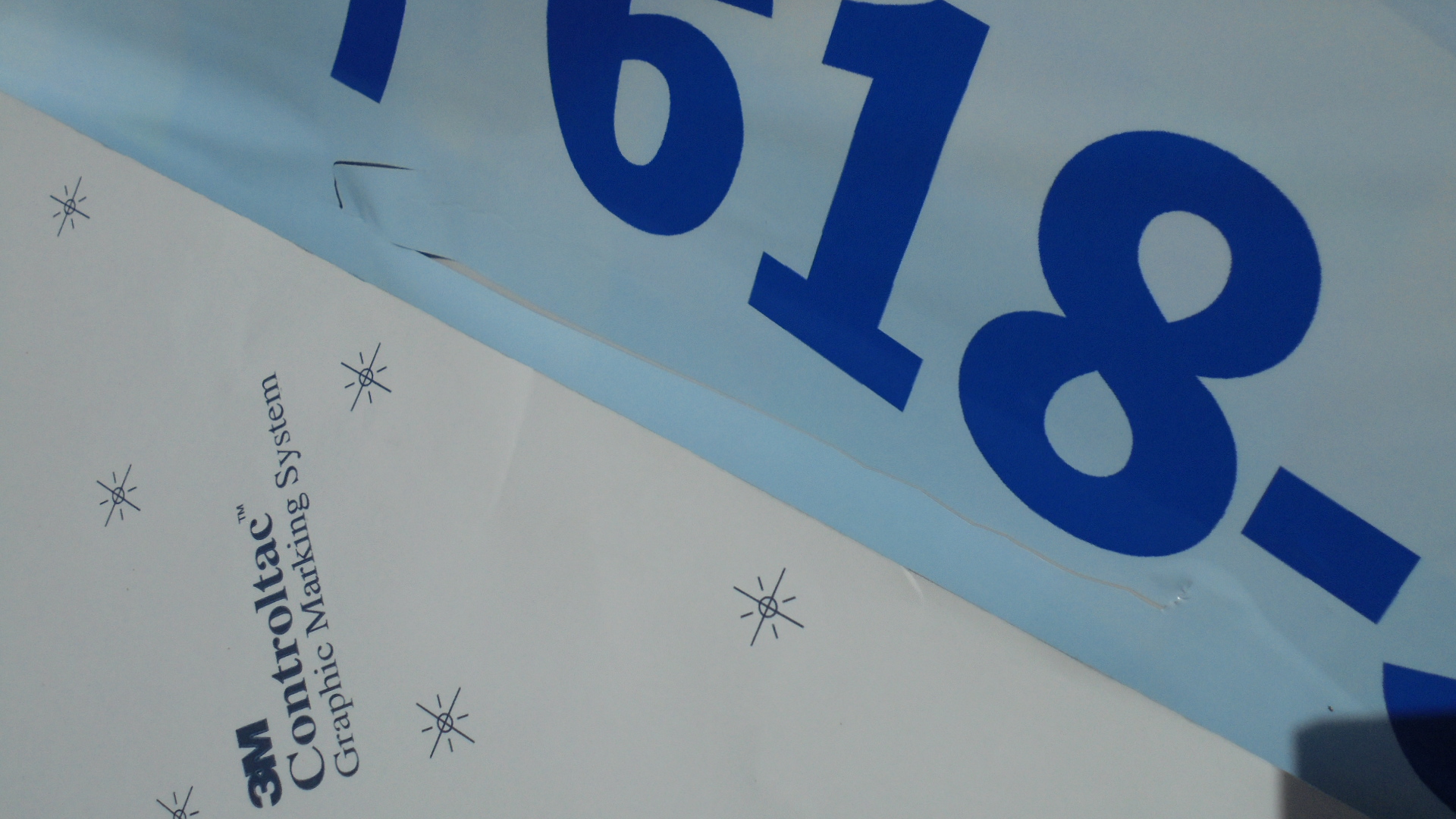

We just applied some customer supplied decals (corporate account). Not sure what exactly it was except controltac with lam. It was miserable. Overly aggressive adhesive that when it touched the paint there was nothing repositionable about it. It was really stuck on the backing too. We couldnt squeegee any air out of it and it tore trying to get in in a groove. Weve applied a ton of controltac in the past with no issues although we use and prefer oracal.

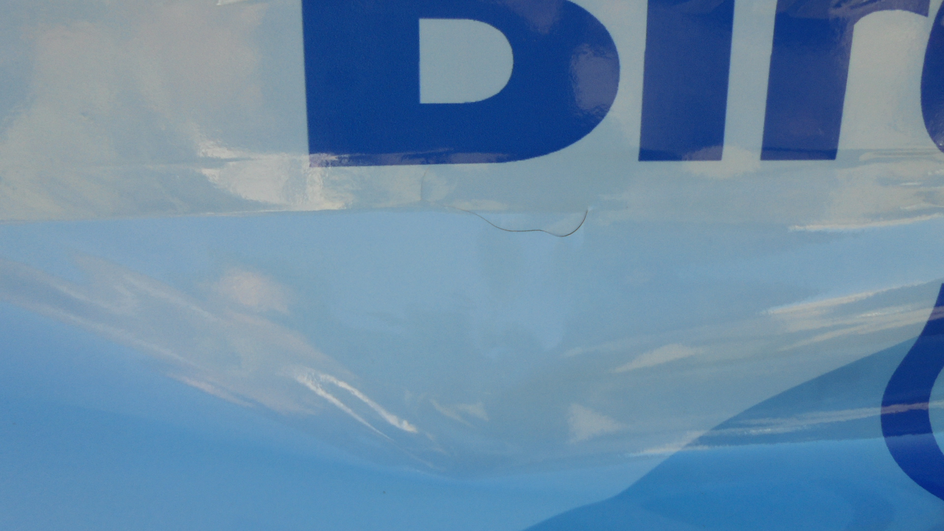

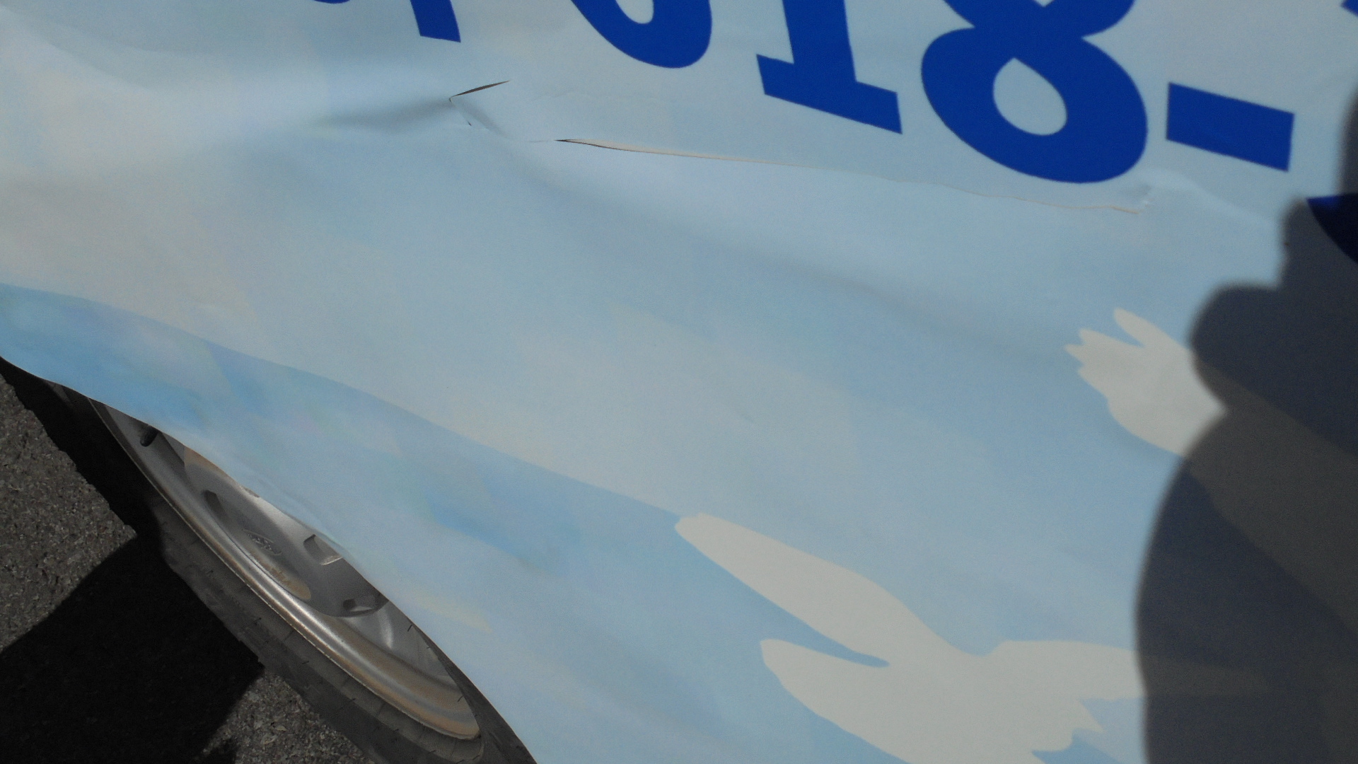

these are clean rips, no stretching or over pulling just tearing everywhere I tried to pull DSC02360.JPG DSC02359.JPG

here are more images of the vinyl tearing up

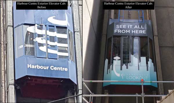

That's off because we just wrapped the exterior of an elevator with the materials and had no issues with materials at all in 2 different temp ranges (day 1 was 30C and day 2 was about 12C). Stuck with no issues at all but released when needed. Wrapped like a dream. Could just be a bad roll or some user error somewhere down the line (i'm not saying that you don't know what your doing but we all make mistakes).
